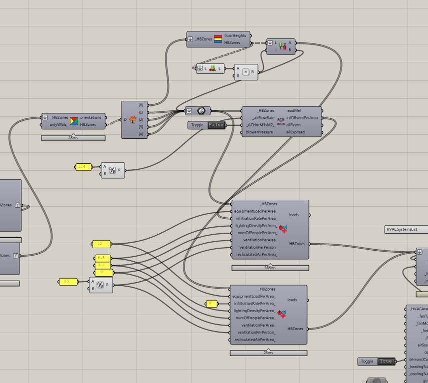

I have a minor issue with the component ACH2m3/s-m2 Calculator. The component send me this red warning : “1. Solution exception:Attempted to divide by zero.” when I use it for converting m3/s-outdoorSurface(m2) to m3/s-floor(m2)
This is due to a null outdoor surface in some zones
Because I generate my zones with the HoneyBee splitZoneToThermalZone component, I do have a zone at each floor that has no outdoor surface. So I have to separate my zones to avoid that issue.
So I separate them with SeparateBaseOnOrientation, and reseparate the middle zones based on floor to catch the upper one and then set infiltration with two component and finally merge them. But this is so messy and annoying :sleeping: :smile:
So would it be possible to do something to fix that in the ACH2m3/s-m2 Calculator component, so it just give a zero infiltration rate for zones who have a null outdoor surface ?
My really outstanding zoning
The current solution I’ve found, which is very messy …
Thank you for all the work you’re doing !!
