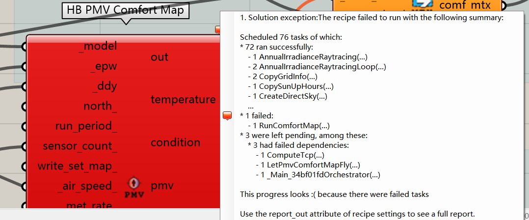

An error occored when using PMV Comfort Map
I don’t know why it happened, does anyone know about it? Thanks for any help!
I tried to test with the official case, but it doesn’t work still… So can anyone help?
Problem has been solved. Just update the honeybee component to 1.4.1 version will do
