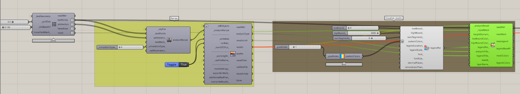

I’m trying to perform my first annual analysis, and i’m facing some issues.

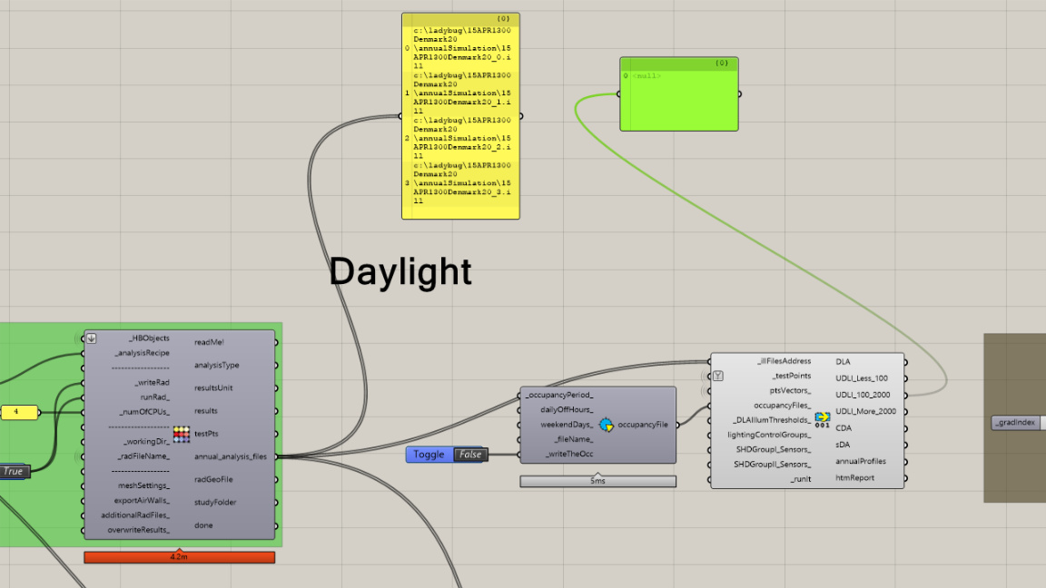

  1. When i run “Annual daylight simulation” i can see on the folder that all values (at list i think) are in generated files, but they are not readed by “Read annual results I”
  1. In the annual radiation analysis i obtain this error in “Analysis grid” component:
  1. Solution exception:
    Failed to import honeybee:
    No module named honeybee.radiance.analysisgrid

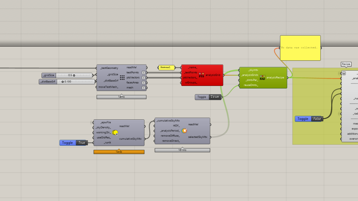

  1. How do i run annual illumnance analysis?
I have tryed the same procedure used for the hourly one, but changing the sky with “generate cumulative sky”. unfortunatly obtaining no result.
this is the file i’m working on: Honeybee.gh (883.2 KB)
Thanks
Hi @kdm.nivek,
  1. You should set the runIt input to True.
  2. Why are you using Honeybee[+] components with Honeybee?
  3. Read the output from readMe!

Hi @kdm.nivek,
Your geometries were not internalised in GH file.
and it’s not possible to use HB+ recipes for Honeybee simulation, they’re separate from each other.
However, see the example files:
Honeybee Daylight Example files
