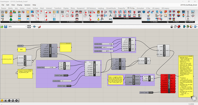

I’m new to Honeybee and I am trying to run a daylight analysis (I am referencing this video). I’ve installed the latest versions of Honeybee and Radiance as directed and I am still having issues. Would anyone know what the problem is? I have attached an image of my whole script with the error message.
you have the wrong version of radiance installed @cloudsnakehelix I would use the pollination installer; as it will take care of versioning and installation of simulation engines etc. this link will install the grasshopper side of things and the related dependencies.
hopefully that works and this was helpfull
Thanks so much @TrevorFedyna , I’ll try your solution and see if it works :slight_smile:
