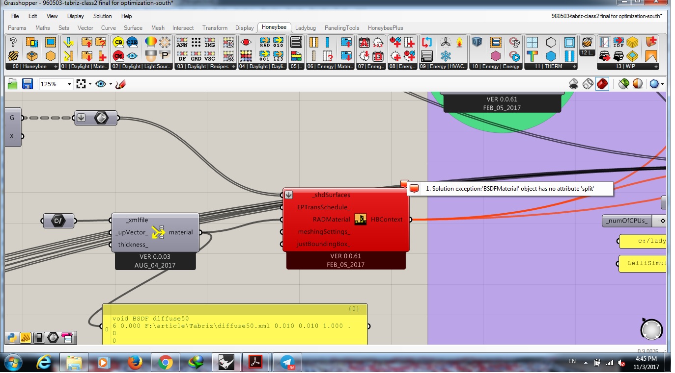

I have created a BSDF material and give it to context but it makes an error :
object has no attribute split
I don’t know what to do with it and how to fix it… can you please help me?

You need to update your Honeybee and LB version also your file components, it should works fine.
You’re mixing Honeybee[+] components with Honeybee components. That won’t work. Replace your current BSDF material component with the one from Honeybee.
hello @mostapha
yeah i’m mixing honeybee[+] because when i use honeybee component , the daylight simulation doesn’t run. And as you said in one topic the daylight simulation doesn’t run with honeybee bsdf component. So what should I do now? :(:confused:
Figure out why it doesn’t run and fix it! Using Honeybee[+] components doesn’t solve the issue. Honeybee has a similar component to create BSDF materials.
