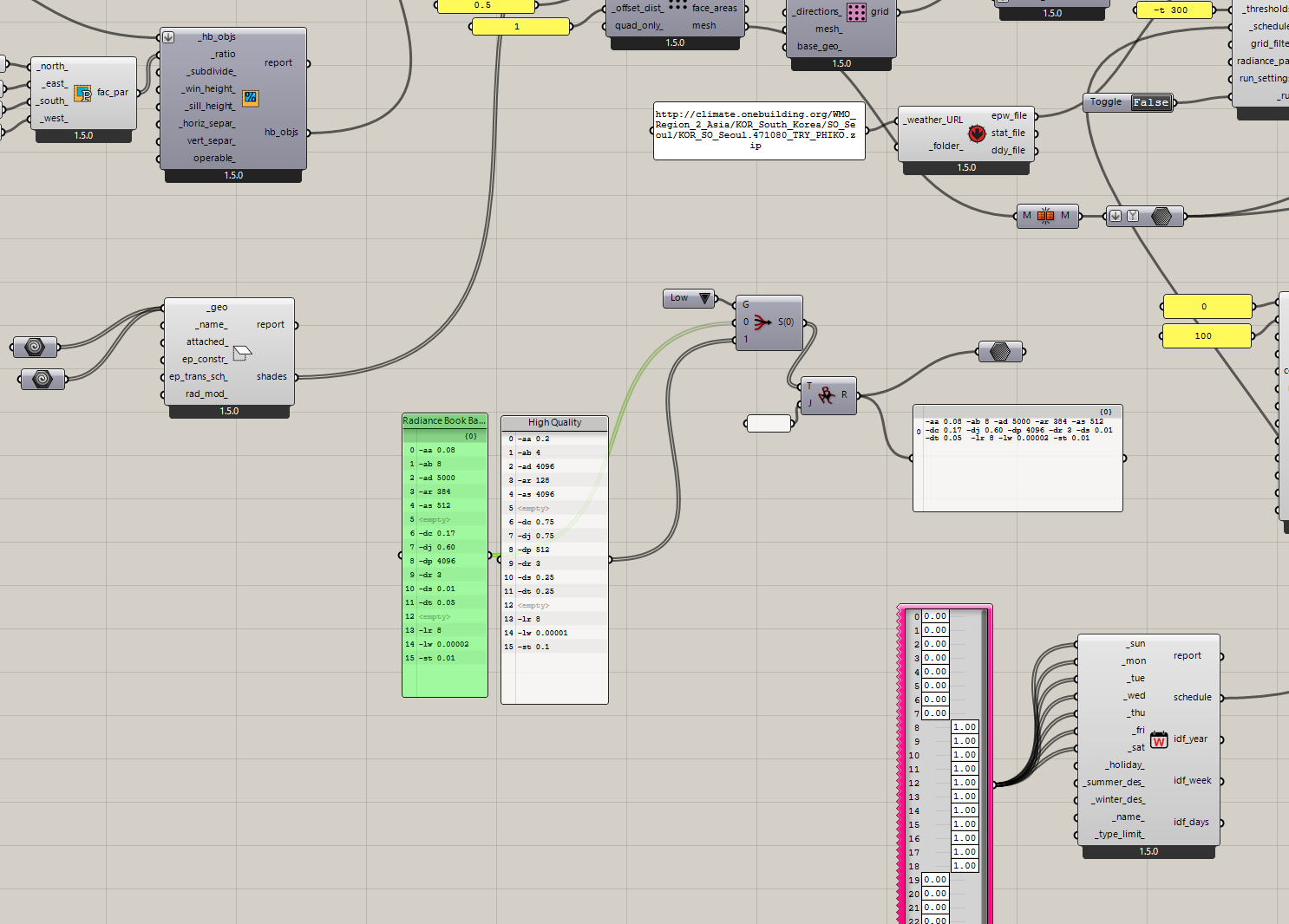

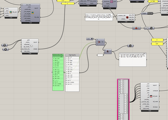

Me and my colleagues would like to know, which parameters would you recommend?
We are using these and would like to know if they are ok?
When you understand what each of the different parameters do, you’ll realize that there’s no one set of recommended parameters for all geometries. But you can use the HB Radiance Parameters component to get recommended Radiance parameters for different levels of quality. If you need to capture low light conditions, you should be using a minimum of “medium”.
