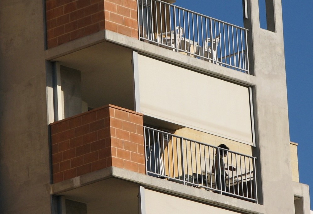

In my current research, I am studying the effect of smart dynamic shading devices on the energy consumption of an indoor space adjacent to a balcony.
These shading elements are designed to move vertically — adjusting their height intelligently from just below the ceiling of the upper-floor balcony down to the top of the parapet.

I aim to evaluate the effect of this smart dynamic shading system, positioned above the balcony parapet as shown in the image, on the energy consumption within the interior spaces of the building.

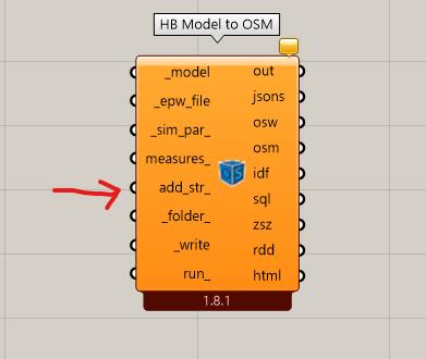

@mary You likely will want to use energyplus ems to accomplish the task at hand, fortunately there is a detailed example of using ems for shade control found here
you would input your ems script on the add_str_ input on the simulation component
