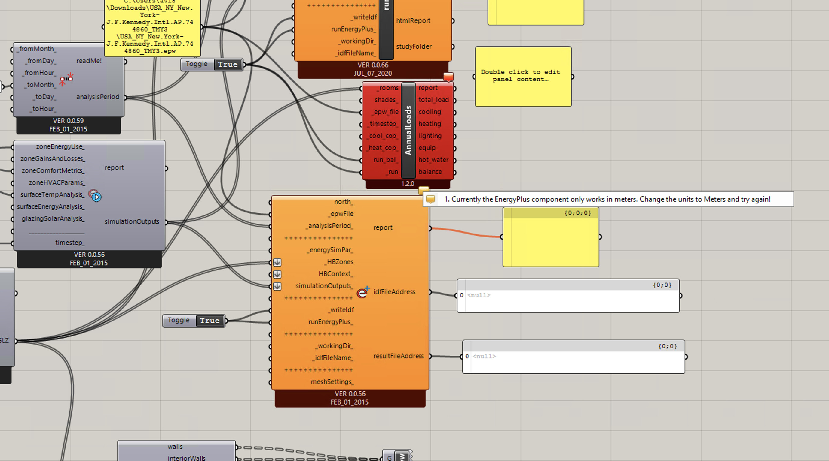

Hello! I was trying to run EnergyPlus through Honeybee. I am trying to run it through a legacy version as well as the latest version, and both are giving me separate errors. How can I make it work? I am confused by the error on the legacy version - “Currently the EnergyPlus component only works in meters. Change the unit to meters and try again!”. I have a BREP which has internalized all the geometry, and I baked it into Rhino and converted the unit to meters. I’m unsure what else to do.

Hello @aishuiyer1 you need to update to the latest version of legacy version. Run the updater and restart grasshopper

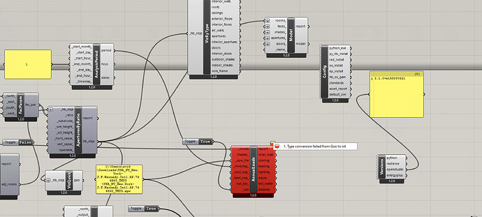

Thanks for responding to my question. I was trying to share the new version’s error too, but it allowed me only one picture. Once I do the upgrade, I get this error! Would you happen to know how to fix it?

I think there is something wrong with your geometry. Check the “Rooms” input again.

Thank you for your response! However, I took this geometry from Chris Mackey’s online tutorials. I am sharing a link to a Google Folder with the Grasshopper document and the screenshot of the issue. I’m unsure as to what the process flow should be to run the EnergyPlus simulation without any errors.
Google Drive Folder: Grasshopper-Honeybee Issue - Google Drive

Disconnect the time step input and try re running it.
