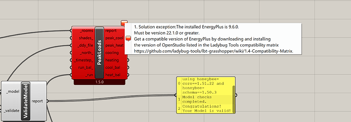

I am having a little trouble with LBT Version 1.5.0. It is unable to find my EnergyPlus v22 install. I have it on path and I also have it installed in the default location. Where is LBT Version 1.5.0 looking for EnergyPlus v 22? I tried looking in the version checker component, but it is buried in some other classes. I think that is my problem here, anyway.

Here is the answer to my own question. Use ‘HB Config’ component to find path.
FYI, @Geo_curious .
If you use the new Pollination single-click installer to do your installation, you will always get a compatible version of EnergyPlus with the Ladybug Tools that is installed:
