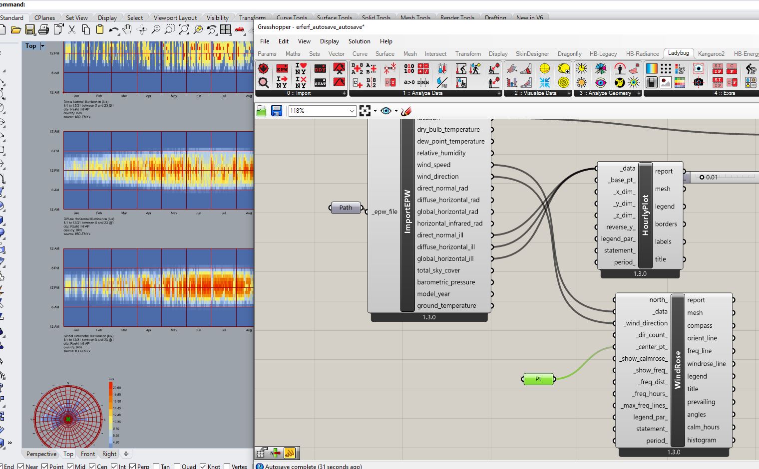

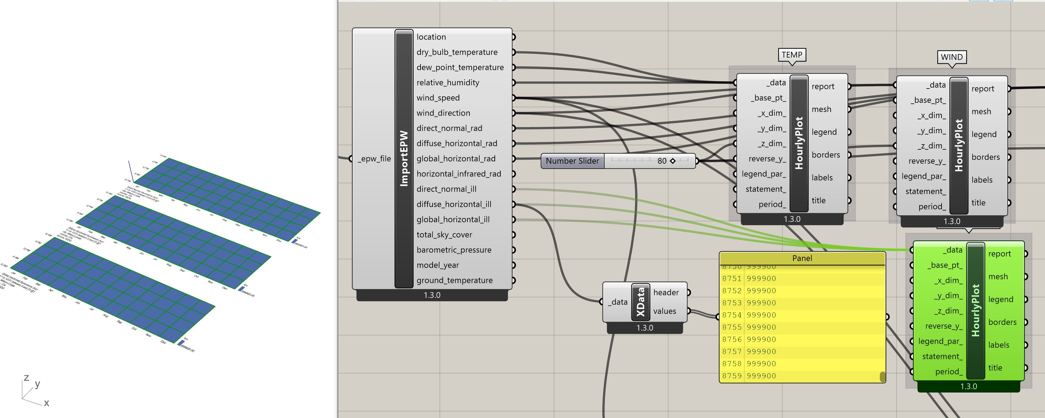

I am testing the latest version of Ladybug and I am working on garphs for weather data from Milan.
My illumination data comes out wrong…
It looks like it is happening with Italian cities(I tried 3 and they all come the same).
Also the Wind Rose fro Italian Cities looks unusual.
I found on Line a Wind Rose from Milan that looks very different.
Anyone has any idea what is wrong?

hi @Juls
I tried, everything seems to be working fine. Please upload your file.

Hi @Juls ,
Some of the fields for certain EPW files are “filler values” indicating that the data is missing or unavailable. That seems to be the case for the particular files that you looked at bere. Particularly because the EPW illuminance fields aren’t used by EnergyPlus or Radiance, I imagine that the author of those EPW files still thought it was worthwhile to share the EPW even though they didn’t have data for those fields.
If you really need this illuminance data, I know that all of the EPW files distributed by the DOE will have these fields. These types of EPWs with missing data will only be found in the EPWs distributed by OneBuilding.
