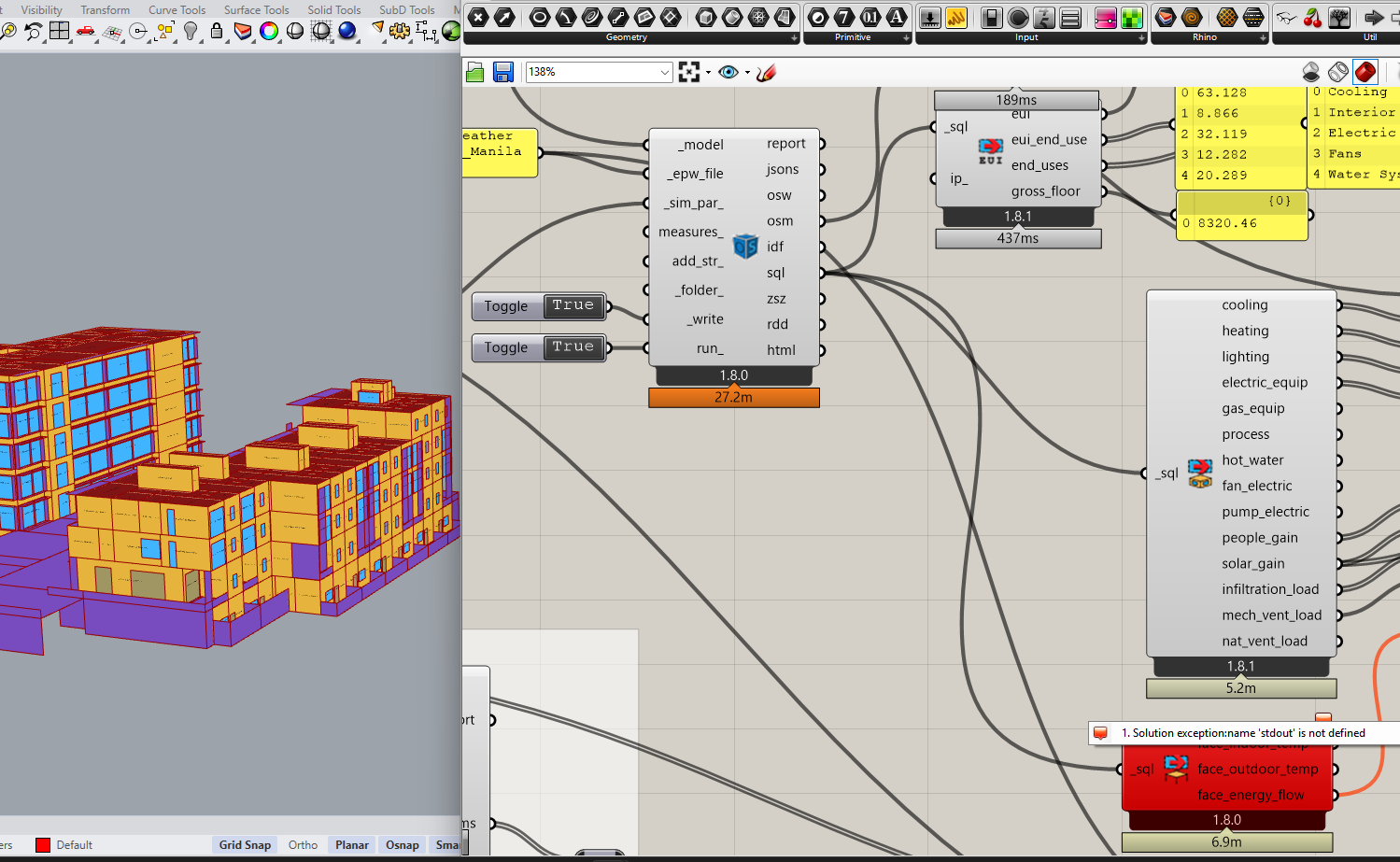

I am doing an energy analysis for a project with two buildings and would like to see the surface temperatures and energy flow of the building envelope. I am getting an error message from the HB Read Face Result component saying “1. Solution exception: name ‘stdout’ is not defined.” Please see the attached screenshot.
The simulation finished with 0 severe error and some warnings, but I am not able to see the information that I wanted because of this error. The error did not appear when running the simulation for each building. It appeared only when they were combined in one simulation suggesting that the model size has something to do with the error. I tried looking for a clue as to what is causing this error from the script of the component. Although I can understand only a little python, I think maybe the problem is in the size of the sql file being processed by the component. The sql file generated was 4.58 GB for the two buildings while the size is 2.32 GB when simulating one of the buildings. I hope I have given sufficient information that can help resolve this issue. Any advice is highly appreciated. Thanks in advance.
