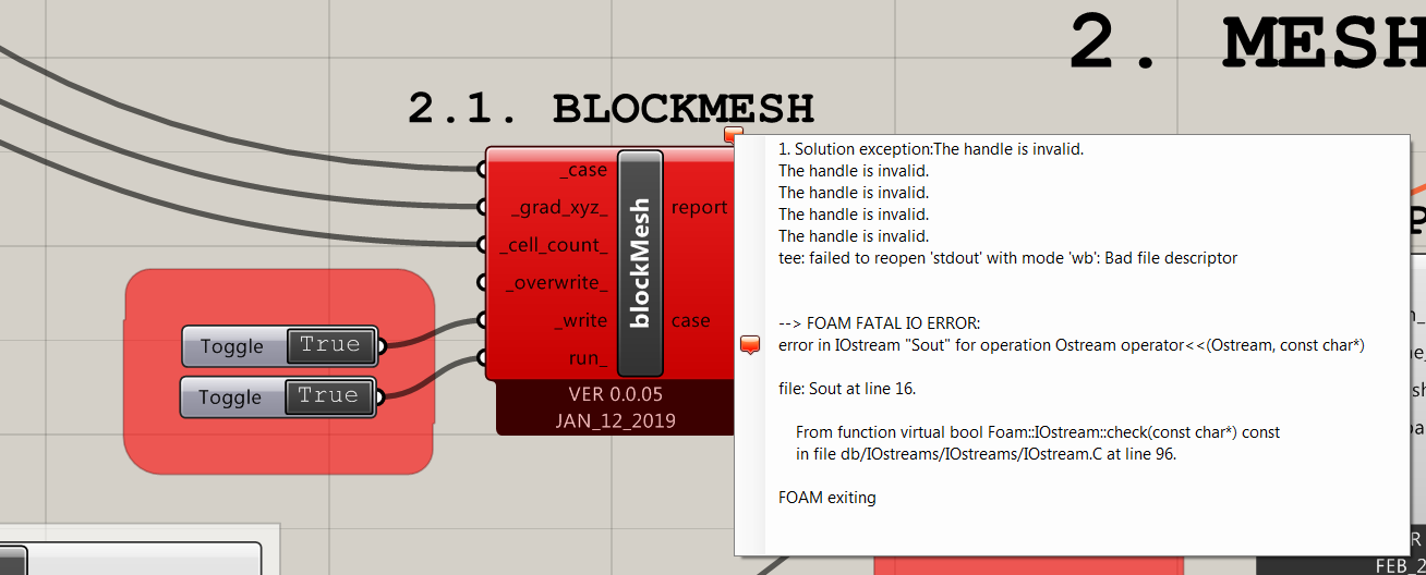

I was going to try it , installed BluCFD and it seems to work
but I get this message from butterfly and I am stuck
any advice whats going on ?

Dear Asisnath
I have tried all files found in the examples folder and they behave all the same way
when it comes to tick the blockmesh write and run I get these error messages
so clearly something is wrong on my pc
windows 7 64 bit professional
Blu CFD is working correctly
gerry
I think bluecfd core runs on Windows 10 only. The files run well on my system.
I have installed both Blu CFD on a new machine with windows 10 and butterfly
and again nothing works. Eddy3D works fine so I think the problem is with butterfly
maybe a non updated version is online
nop , BLOCKMESH says Solution exception: WindowsError
this bug is reported and fixed here
