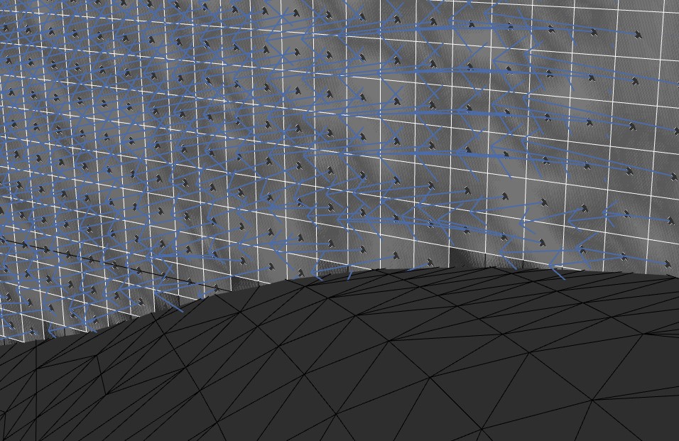

Hi all, I have been trying to generate the wind pressure but the result are way off and I am not sure how to solve it.
I just wanted a cross section of the wind pressure
the arrows does follow the roof form but the colours did not show
and the results are way off…
I am not sure what I can do to resolve this
Here is the file for reference
Why don’t you check the calculation results in Paraview? I think it is probably calculated correctly. If you set the highBound_ and lowBound_ of legendPar, it will be displayed correctly in Rhino.
