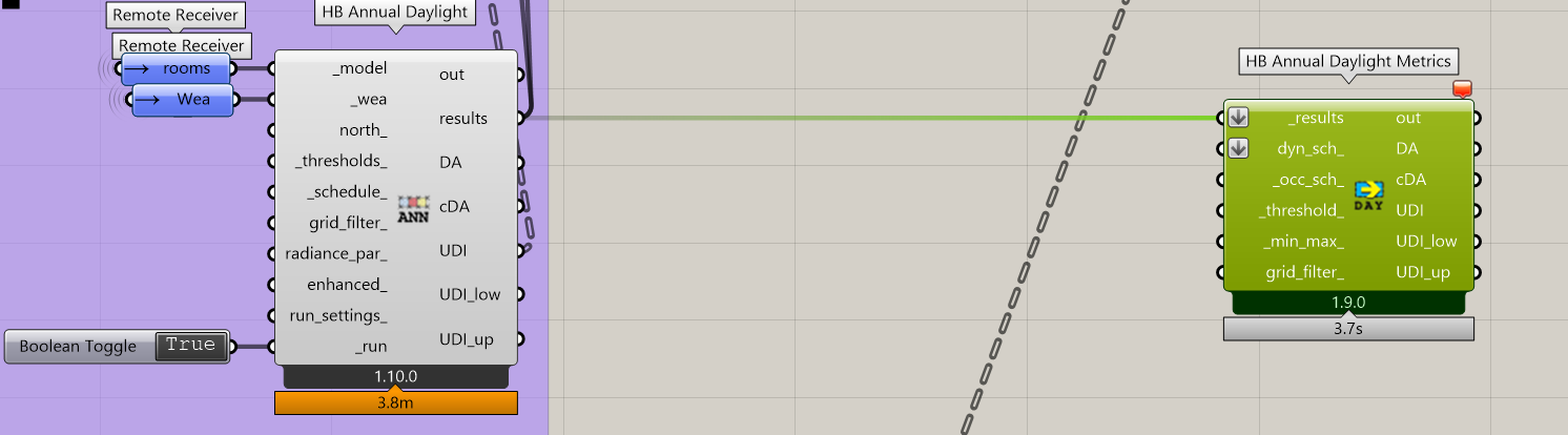

red Bubble is showing this error [exception: Failed to compute annual daylight metrics.]
I suggest that, before checking anything else, you apply the Versioner component to update the LBT to its latest version.
From the image, I see that the Daylight calculations use version 1.9, while the Annual uses 1.10.
Bring everything to 1.10 and then check again.
Thank you it solved my problem :grinning_face: .
