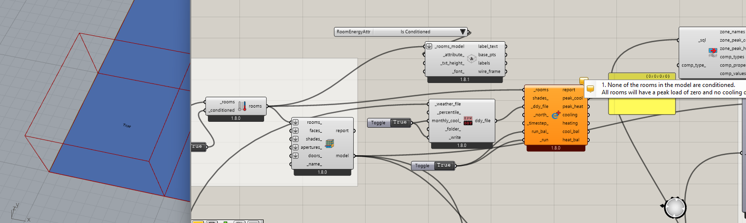

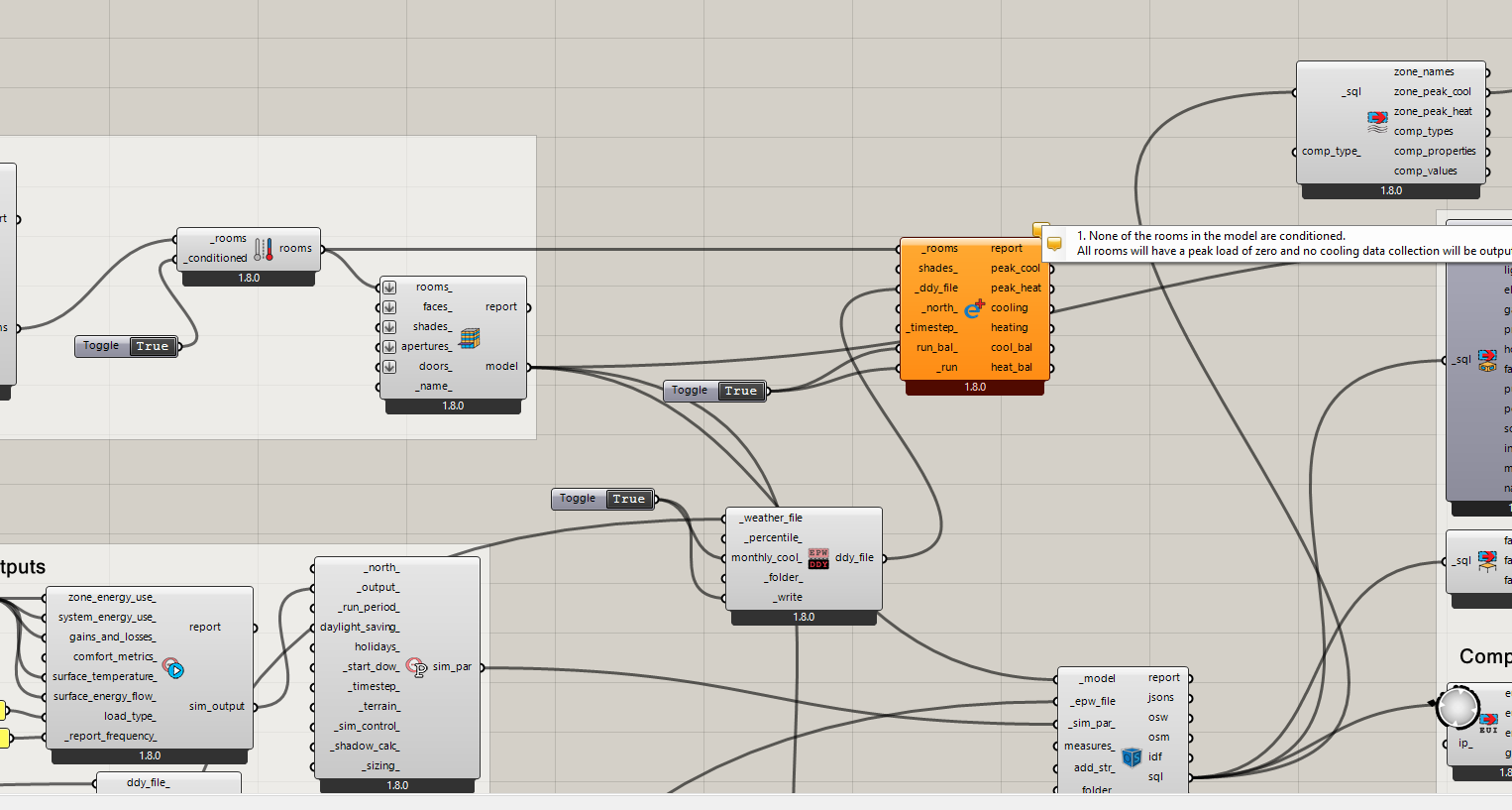

I am trying to generate the results for peak cooling loads through the HB Peak Loads Component to compare with those generated through HB Read HVAC Sizing. I receive error information that makes no sense to me. I checked the inputs, and everything is correct, hence I am looking for suggestions on the forum. I really appreciate any help you can provide. :slight_smile:

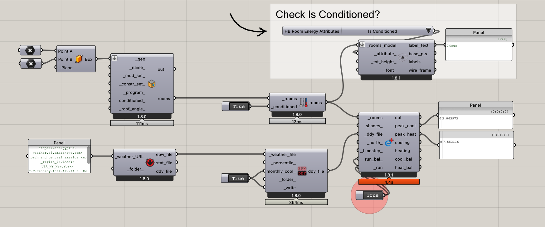

Seems to work ok for me? Maybe try checking ‘is conditioned’ using the Room Attributes:
@edpmay
Example File:
example.gh (42.0 KB)

The room attribute indicates that everything is alright. Can this be a sort of bug triggered by the room setting itself? Have you had such an error before?

The HB Peak Loads Component does not like the space program to be “Plenum” or empty, which was the case for my study. Other way around it is needed
