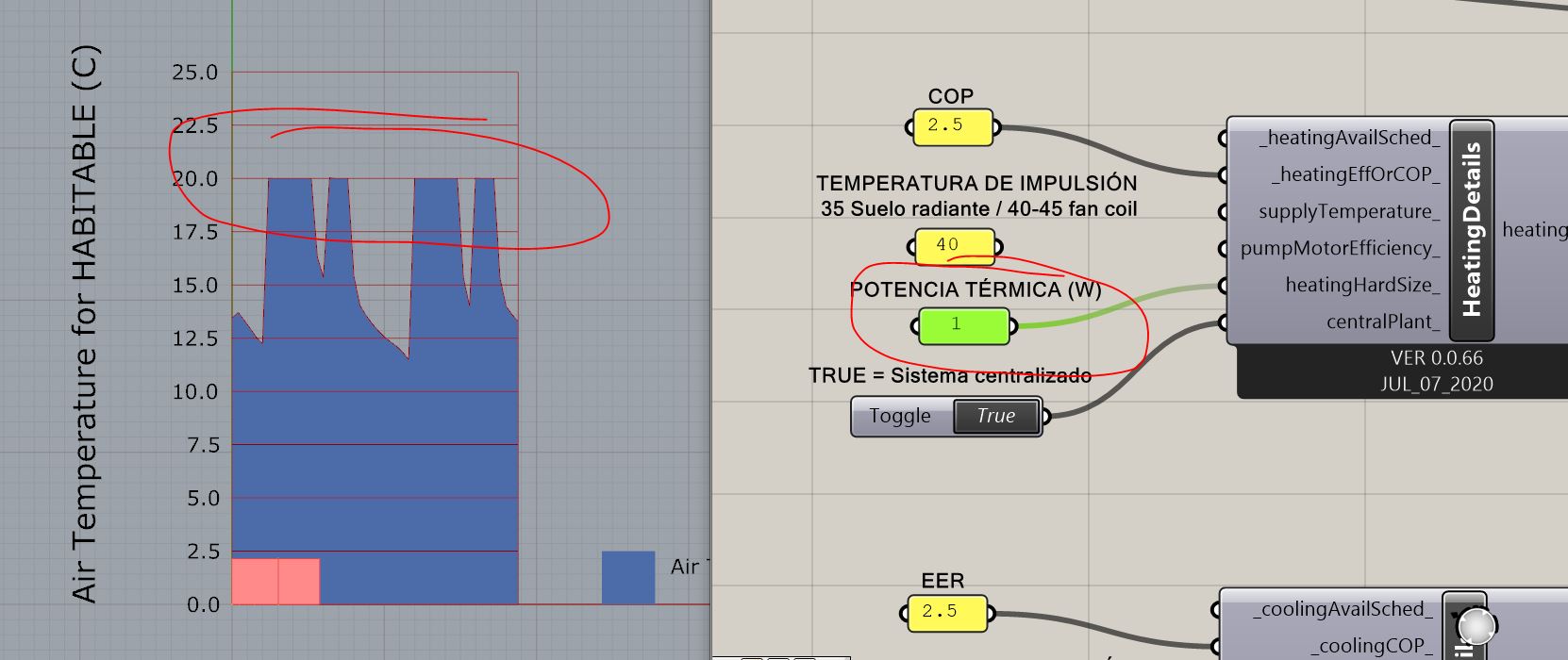

For a space with a heat load of 750W I see that when I change the Power of the Heating, the result doest change.

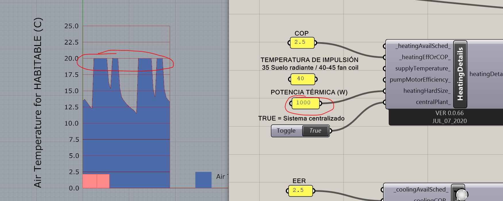

For example, with a heating of 1000W, the space get 20ºC (Setpoint)
But if I reduce the heating, the space is getting 20ºC too. In that case, the temperature should change because the 1W boiler doesnt reach the power.

I set HVAC system list -1. Thermostat Only
