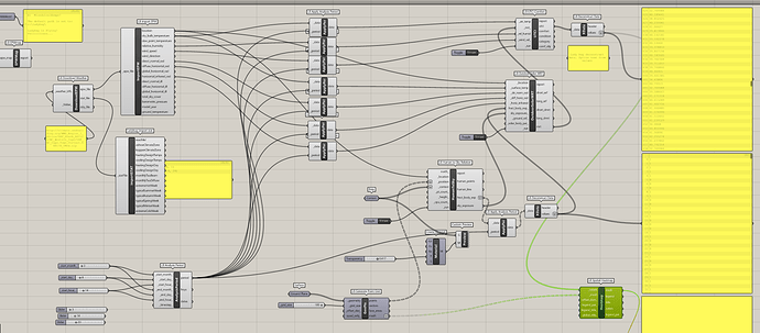

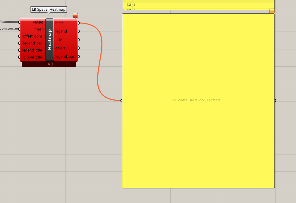

I’m trying to run a UTCI analysis, everything works fine but when I add values to the Heat map component to visualize the data it does not read it. The data is there. What could be the cause of this? is the component broken? I did run the LB versioner component but ii still get the same result.
Search the error message in the red balloon on this forum and you’ll see that this question has been answered many times before. Chances are that you have to flatten and join those meshes into one and it will work.
