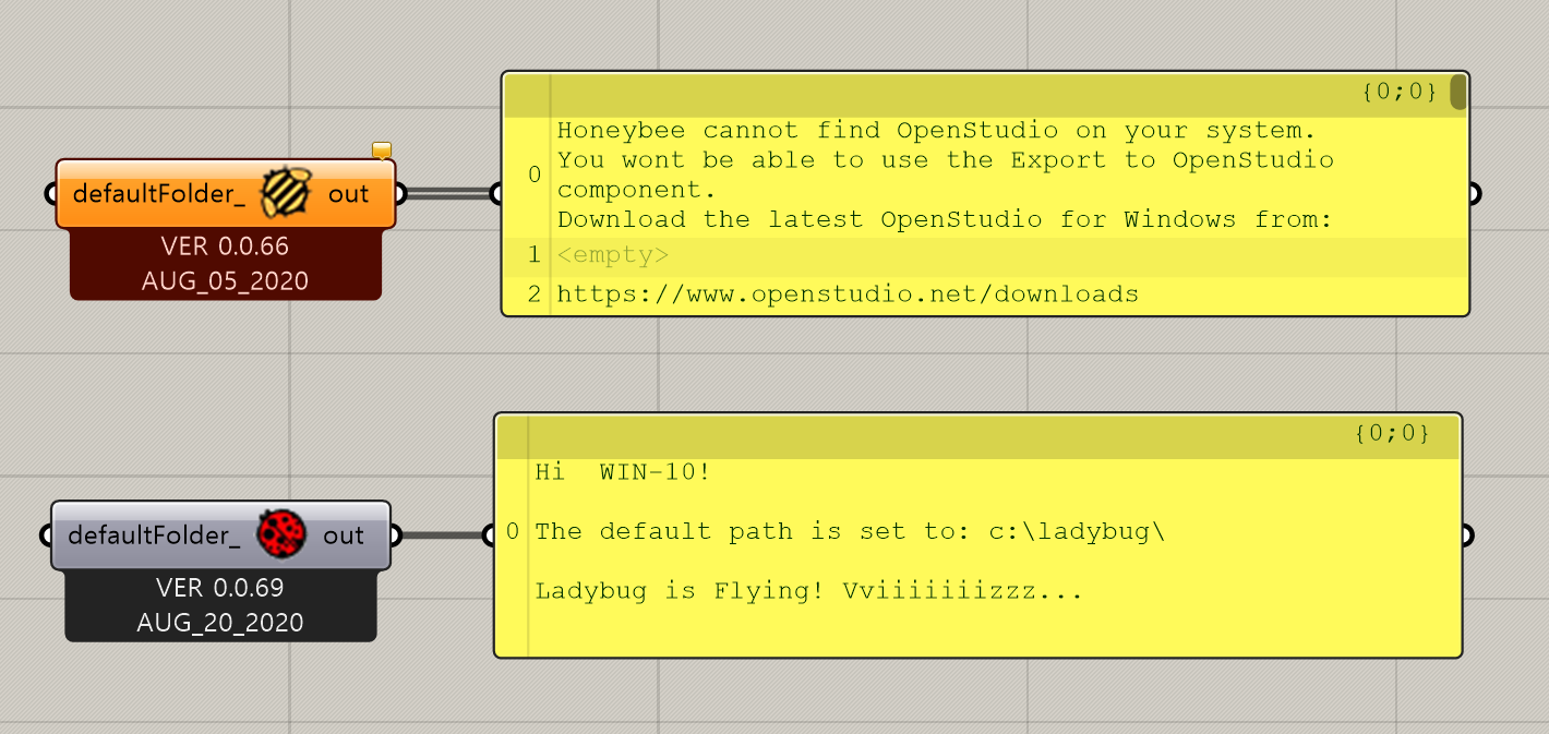

Honeybee can not find openstudio, plz help meeee
It has been confirmed that honeybee version 1.6.0 and openstudio version 3.5.0 are mutually compatible.
The location of openstudios is C:\openstudio-3.5.0, and the location of openstudio application is C:\ProgramFiles\openstudioapplication-1.5.0.
the let honeybee and ladybug fly components are from the legacy package. Not from LBT 1.6.
The new honeybee does not need to be thrown into the air before starting. It can fly on its own.
