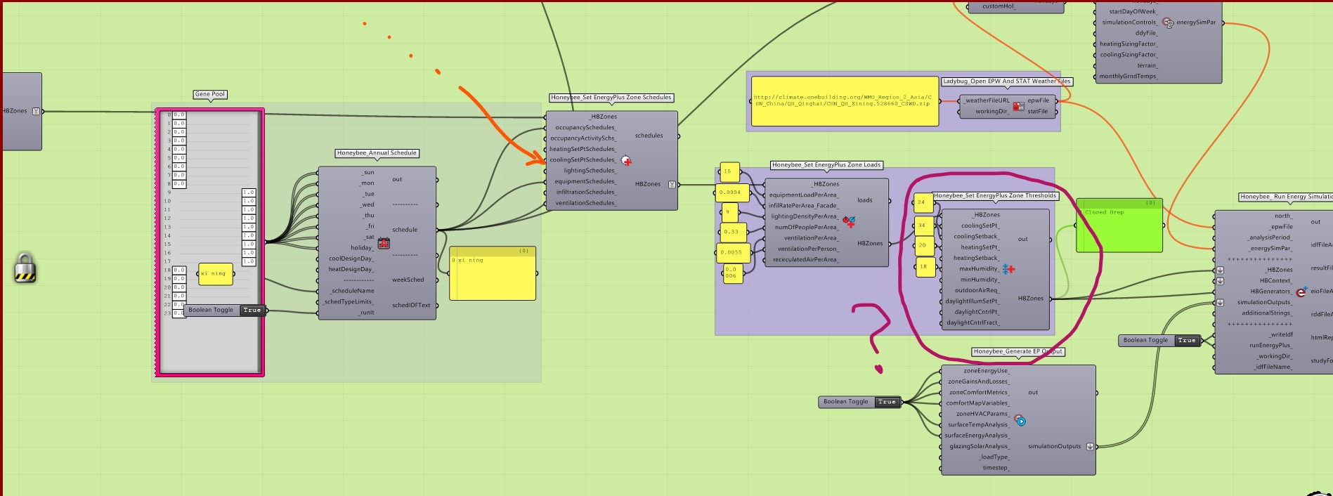

How do you create the "heatingSetPtSchedules" for a specific period of time, such as November 1 to March 31?
I have completed the occupancy schedule for the whole year,but not sure how to determine the heating schedule for a specific period, hope someone can help me :cry:

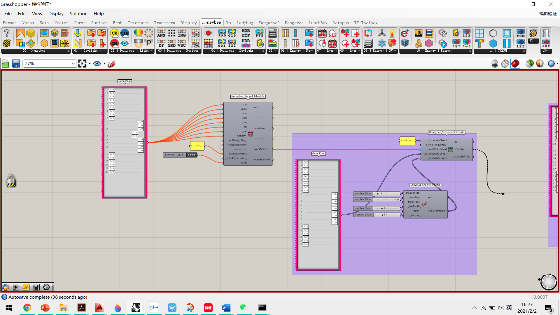

I would try the HB_Honeybee_SeasonalSchedule component for that purpose.
thank you for your answer!!
Is this the way?The generated cooling time schedule is directly linked to “set EP schedules”.

Pay attention that when you zoom in to the component you can add additional schedules (for instance summer/winter). Check the “+” icon.

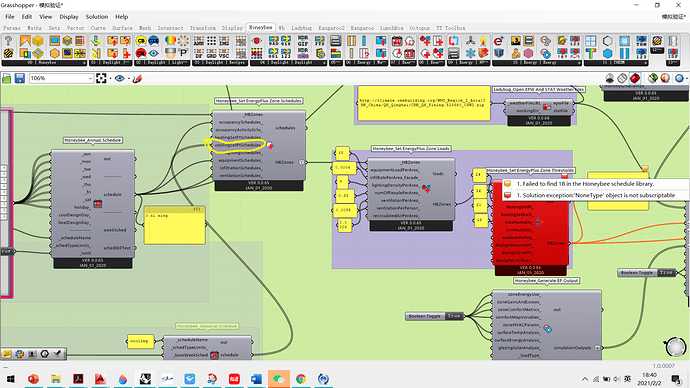

When I plug the schedule into “coolingsetptschedules”, there is a problem in the picture. Is there something wrong with it?
  1. Failed to find 18 in the Honeybee schedule library.
  2. Solution exception:‘NoneType’ object is not subscriptable
I am very sorry that this is also the case with the connection to the heating interface.
