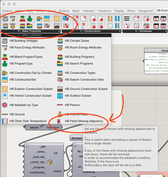

You can just pass in a single zone from your model to the OSM runner. The only trick is that you need to use the ‘HB Patch Missing Adjacency’ FIRST to reset the boundary conditions:

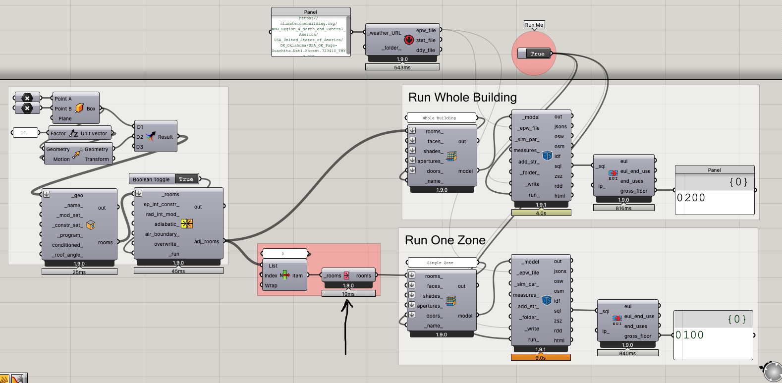

after that, it is just the normal workflow to run the model with on the single zone:
example.gh (59.4 KB)
