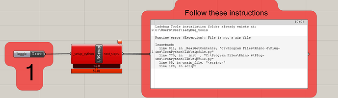

Hi, I just dload and extract ladybug installers and its components when proceed to installation I encounter this problem.
I would appreciate if you can help me.
Thank You.
Thank You.
It looks like your internet connection was interrupted while the component was running and the download of the .zip file failed. If re-running the component does not work, then try deleting the folder at.
C:\Users\[USERNAME]\ladybug_tools
And re-run the component again.
