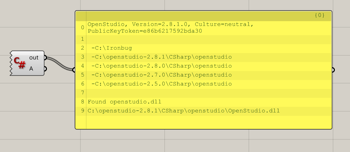

Could you please use this new gh file to check again, it might provide you more info.
CheckOpenStudioVersionLocation2.gh (3.4 KB)
Clearly more information - your check is finding OpenStudio 2.7 which I have removed… I have uninstalled, and re-installed OpenStudio just now (the copy that works at home). Problem persists.
M
@MichaelDonn This definitely provides us a direction to look into.
There might be two places related to this:
  1. By any chance that you have openstudio old libraries (OpenStudio.dll, openstudio_csharp.dll,etc.) copied to C:\Ironbug folder. If yes, please remove them, otherwise, Ironbug will only load openstudio library from this folder.
  1. If the first issue is not the case, could you please go to C:\openstudio-2.8.0\CSharp\openstudio and right click the OpenStudio.dll for properties, and check if this file is 2.8 under Details tab.

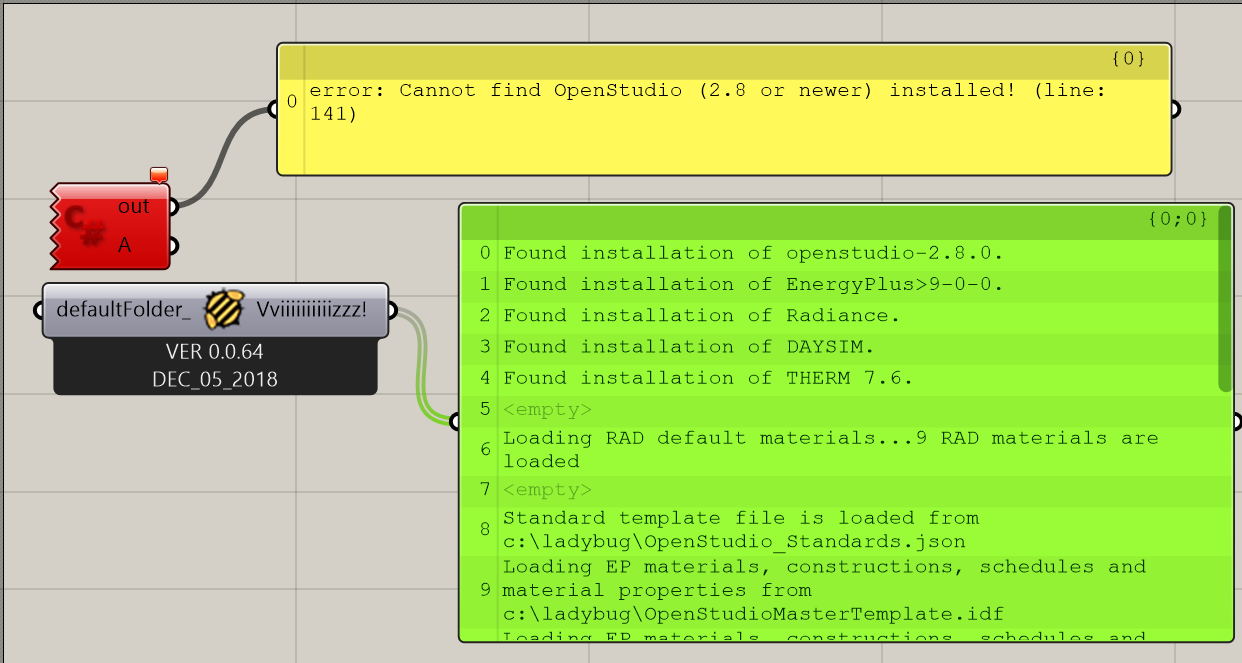

Mingbo…i opened up a Legacy script from HydraShare with no changes made to the script and I now have the following error in the main Legacy run energy analysis component which I haven’t had before:
  1. Solution exception:Unable to find an entry point named ‘CSharp_OpenStudio_toPath__SWIG_0’ in DLL ‘openstudio_csharp.dll’.
i ran the component you provided above and it outputs the following:
any thoughts on how to fix??
Hi @josh.greenfield, it is because you have multiple versions of OpenStudio. Have you tried to use the Pollination installer to install LBT and Ironbug with a compatible OpenStudio version?
