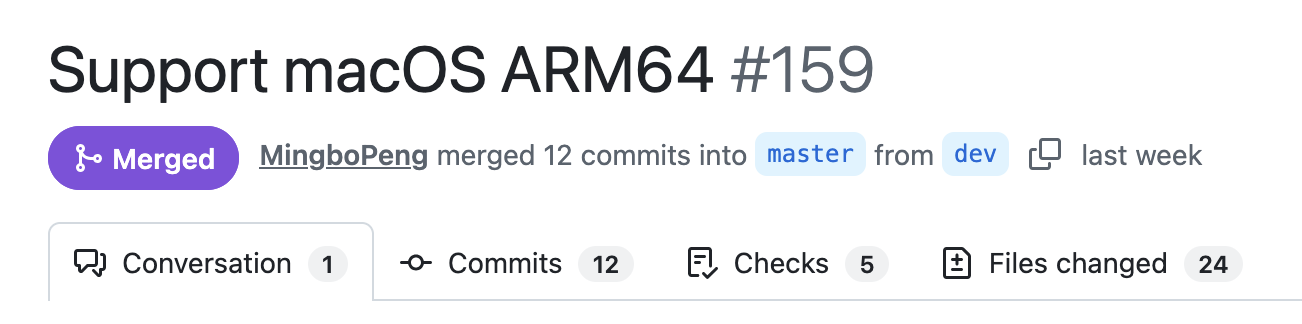

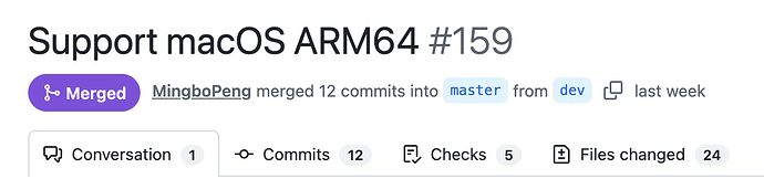

@MingboPeng 's recent PR just came across on my Github feed (PR #159, released in v1.26.1):
It was released last week and I found nothing about it on the forum, so I felt the natural urge to jump in, and as usual, I faceplanted a few times. There’s no Mac installer yet, and some tweaks were needed, so here are the steps for the setup that worked for me, maybe someone finds it useful.

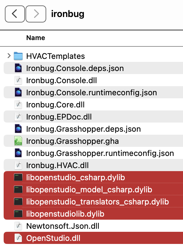

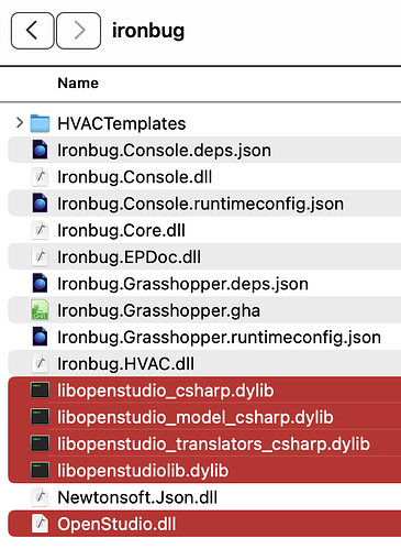

3. Copy the OpenStudio bindings next to the .gha. The Mac plugin zip doesn’t include OpenStudio.dll. Without it I got “Cannot find OpenStudio installed in ladybug_tools folder!” and a load error for every component.
These five files (the four libopenstudio*.dylib + OpenStudio.dll) are in the console zip, in the …/net8/osx-arm64 folder. Copy them next to Ironbug.Grasshopper.gha.
Then run xattr -dr com.apple.quarantine on the Libraries/ironbug folder, otherwise macOS may block the unsigned .dylib files.
xattr -dr com.apple.quarantine "$HOME/Library/Application Support/McNeel/Rhinoceros/8.0/Plug-ins/Grasshopper (b45a29b1-4343-4035-989e-044e8580d9cf)/Libraries/ironbug"

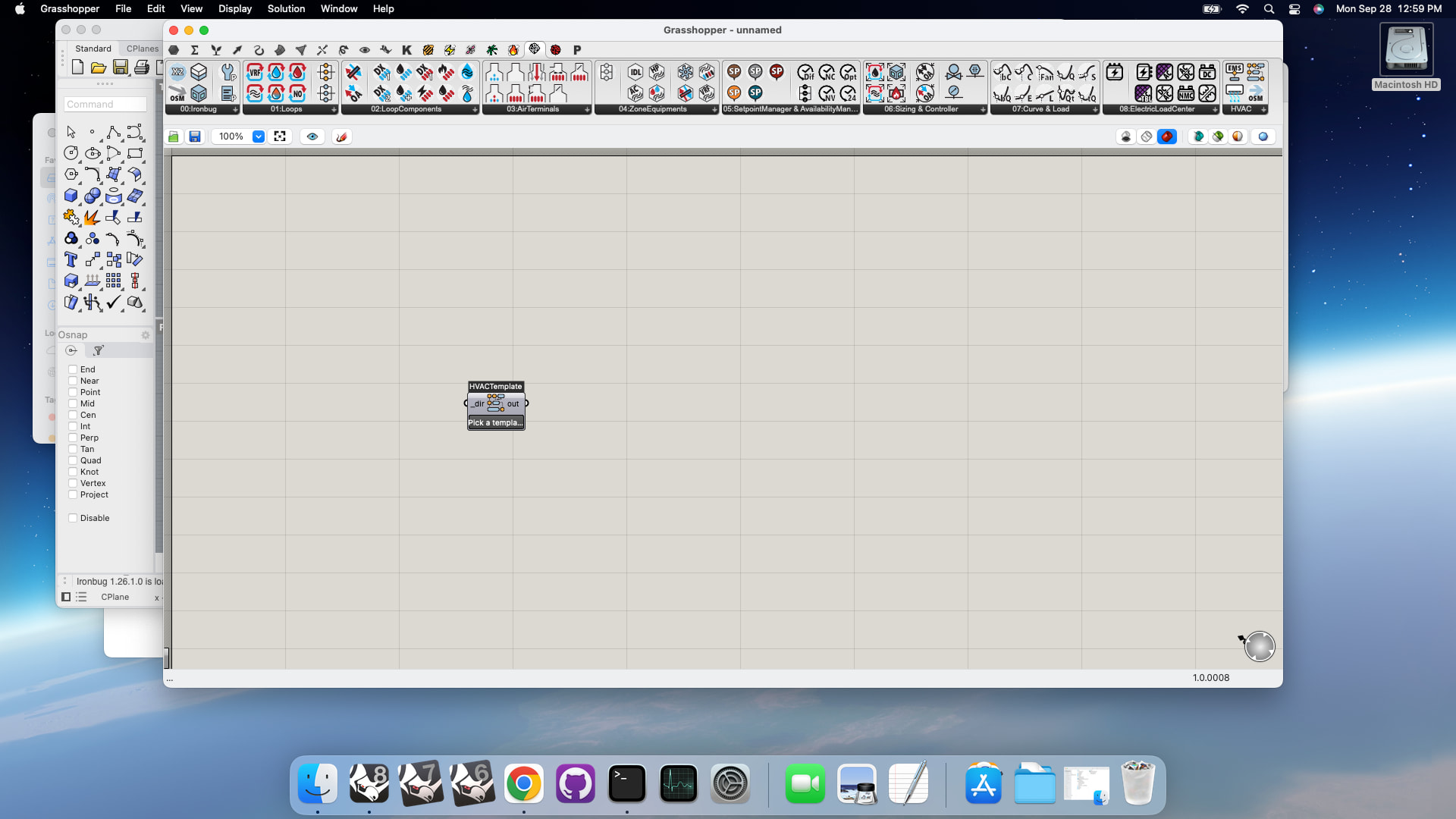

5. Now open Rhino

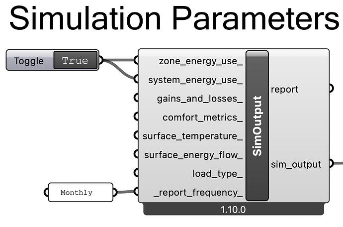

With an Ironbug system, set system_energy_use = True in HB Simulation Output. Otherwise heating/cooling results come back empty:
I’ve tested on the LBT full building sample with Sys00_IdealAirLoad and Sys07_VAV Reheat. EnergyPlus completed with 0 severe errors.

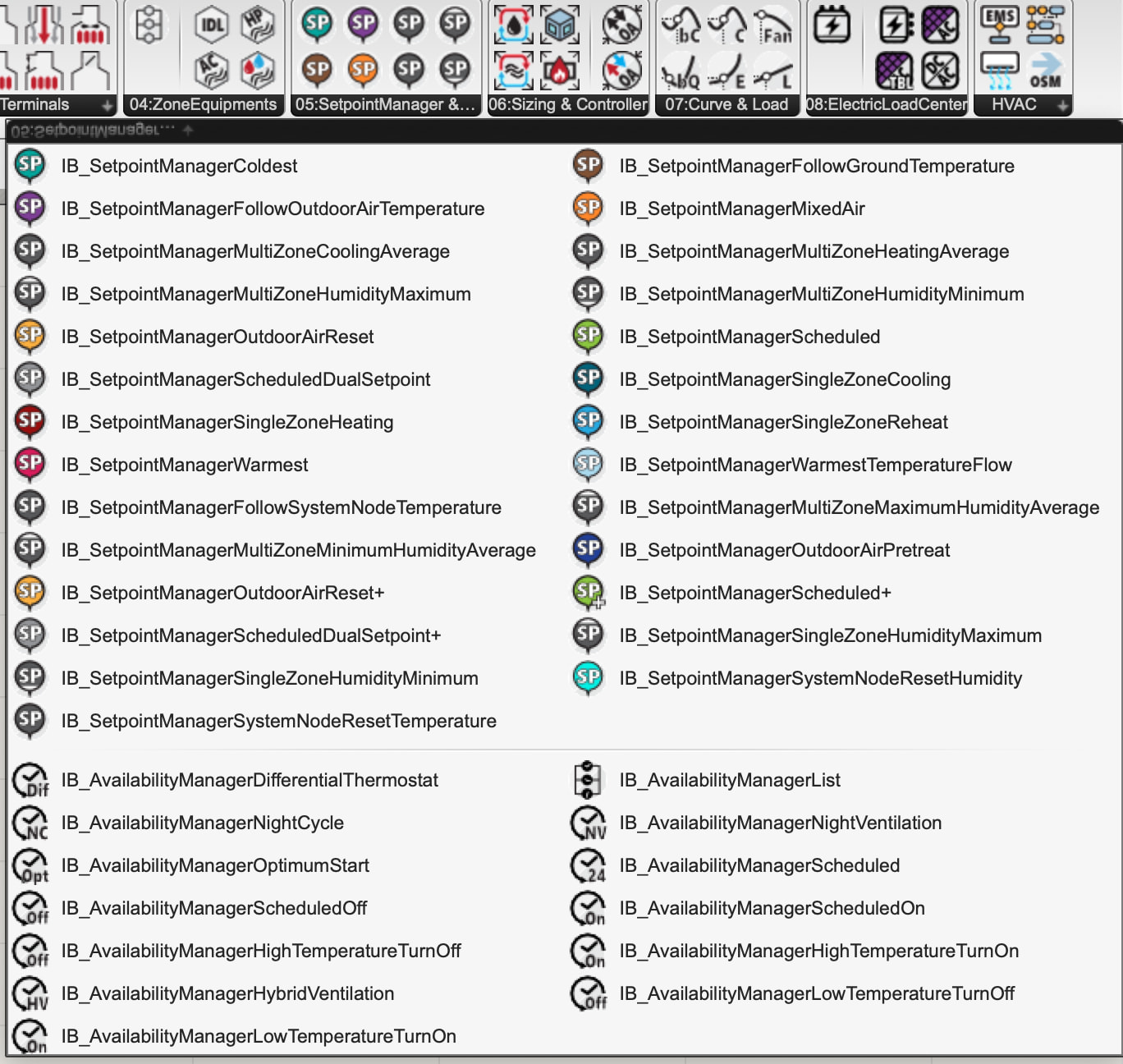

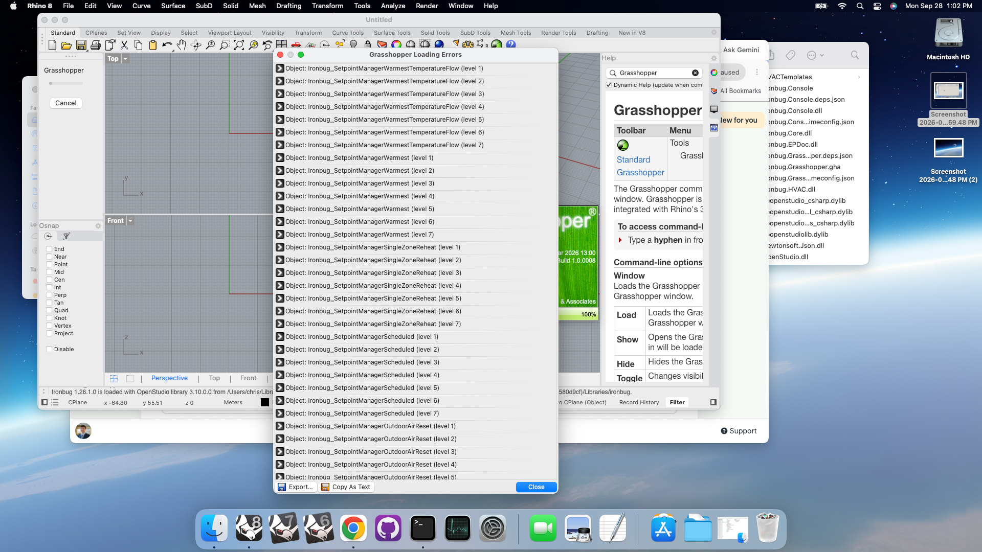

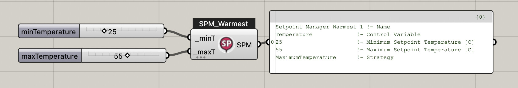

Very helpful. I followed your steps and I was able to get almost all of the Ironbug components to load and work correctly. The only issue I was having is with the Setpoint components:
I was curious if you experienced issues with the setpoint components at all in your tests.
I am also testing this on an old intel-based Mac so it’s possible that this is the source of my issues.

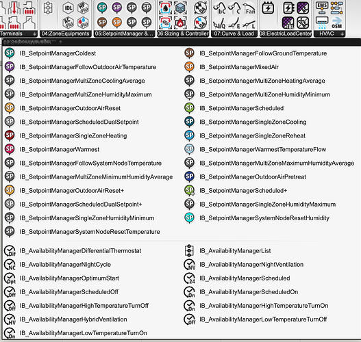

Nope, it loaded everything (since posting I installed it on my Rhino 9 BETA build, and this screenshot is from there):
Quick example:
This could be the Intel Mac, McNeel will drop support completely with Rhino 9.

@MingboPeng just dug through my logs and confirmed that the issue with the setpoint components has to do with the fact that I have an Intel-based Mac. I didn’t realize that Rhino 9 will not support Intel-based Macs. In that case, maybe we should also move on and not worry about this case. In any event, at least we know what the issue is if someone else tries to install Ironbug on an intel-based Mac.
