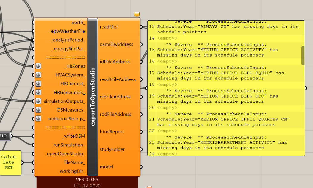

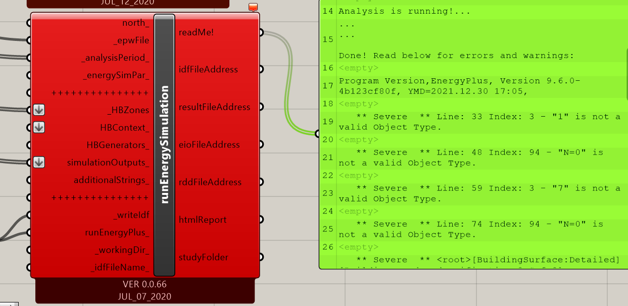

Hey everyone, I am trying to use the component “HB_PET analysis recipe” from the legacy versions of the tools. I also have installed the latest version of the Ladybug tools 1.3.0 and after using LB_versioner the OpenStudo I need to use is 3.3.0.
When I try to run "Export to OpenStudio component it gives me an error:
Also when I simply try to run the “hb_run energy simulation” it gives me another error:
I don´t know if these two errors are related to one another or completely different things. I need these components due to the fact that to calculate the PET I need the result file address.
Does anybody know what can I try to do, would be very helpful. Thank you

Just use LBT 1.3. These types of errors have been virtually eliminated over there.
