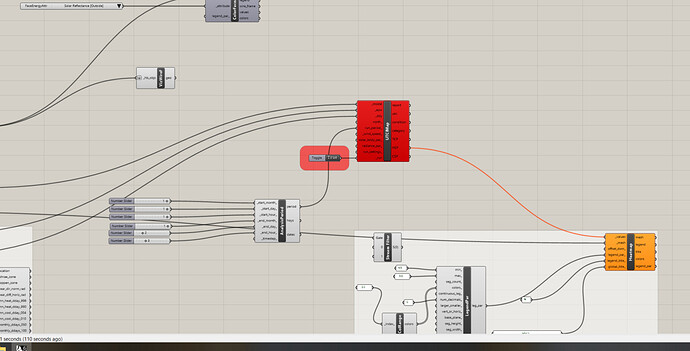

I’m trying to change the analysis period of attached file but it’s not happening, any idea what is the issue ?

This is a known issue in the LBT 1.4 stable release that has been fixed in the latest development version of the plugin, which you can get by running the LB Versioner component. It results from using a run period with only nighttime hours so using a period with daytime hours will also fix it.
