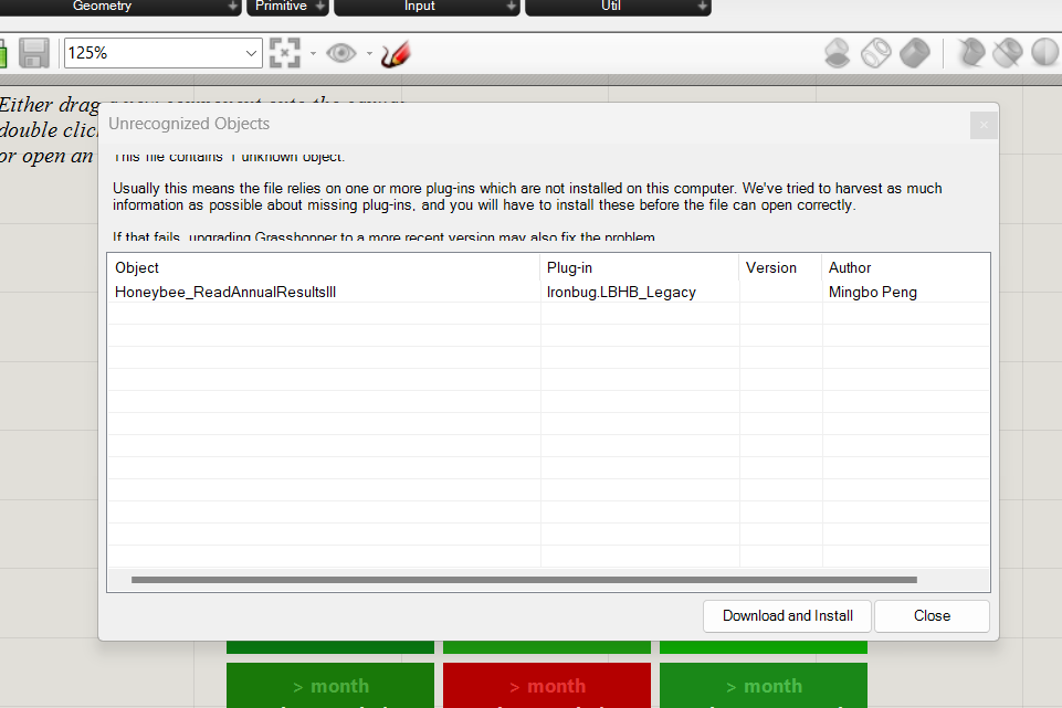

I am trying to open a Grasshopper file but there is a missing plugin (Ironbug.LBHB_legacy) and the software suggests downloading and installing it (my version is 7). When I do that an error comes.
I was informed later on that Ironbug.LBHB_Legacy has been removed from Ironbug and has been included in the last Ladybug Legacy version (2020-01-01).
I downloaded the Ladybug Legacy version (2020-01-01) from Food 4 Rhino and copied and past it into Grasshopper/file/special folder/ user object folder, but the problem is the same as shown in the photo below. I would be grateful to receive any kind of support for that
Hi -
From that picture and @MingboPeng’s answer on the Rhino forum, it looks like you need to replace the obsolete component in the definition with the one that is part of the last Ladybug Legacy version.
-wim
