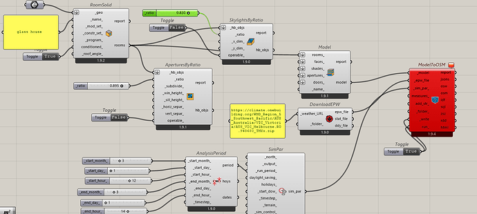

Hi, I keep getting error when i try to export solid model to the open studio.
  1. ** Severe ** Line: 650 Index: 0 - Object contains more field values than maximum number of IDD fields and is not extensible.
  2. ** Severe ** Line: 650 Index: 0 - Error parsing “ZoneInfiltration:DesignFlowRate”. Error in following line.
  3. ** Severe ** ~~~ Outdoor; !- Density Basis
  4. ** Severe ** Line: 650 Index: 9 - “Outdoor” is not a valid Object Type.
  5. Solution exception: ** Fatal ** Errors occurred on processing input file. Preceding condition(s) cause termination.
Does anyone know why is it?
Thank you very much

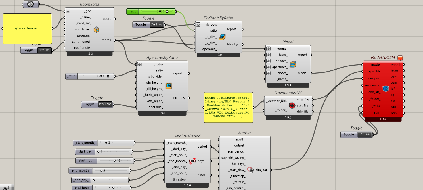

Try doing a check on the model using HB Validate Model, trying diferent conections since from what we see on the screenshot, it’s just a opaque room?
I am getting the same error even with the example files provided by Ladybug.
I have passed the model through HB Validate Model and it doesn’t show any errors.
It looks like you have accidentally installed a newer version of OpenStudio/EnergyPlus. Make sure that you are using the version in the compatibility matrix:
