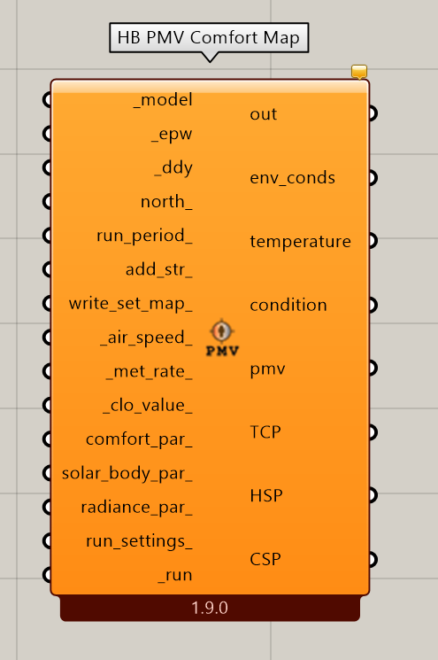

@FrancescoEmanuele I believe this is the component for you:
_model: A Honeybee Model for which PMV comfort will be mapped. Note that
this model should have radiance grids assigned to it in order
to produce meaningful results.

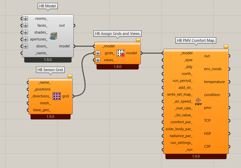

So don’t forget to add the grids where you want to simulate:
basic workflow:
