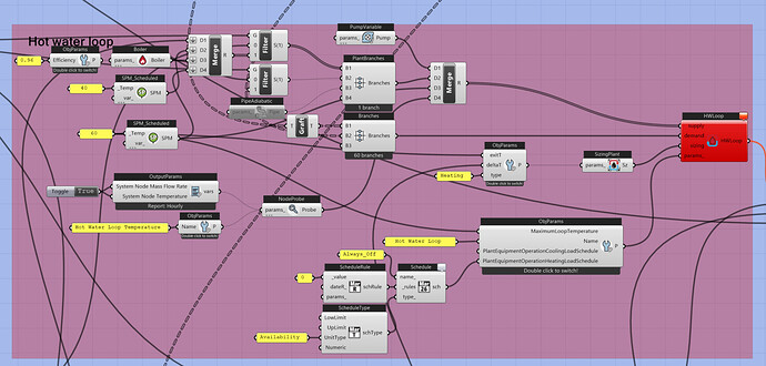

Is there any information about how Ironbug is creating the plant operation schemes or ways of modifying them? The image below is from the IDF showing the HeatingLoad scheme, then the Component Setpoint as the second control type.

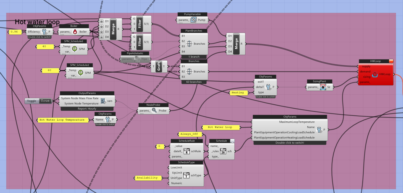

I would actually like to use the Component Setpoint only, but I don’t see a way to specify this in any component. I did try revealing the schedules for PlantEquipmentOperationHeatingLoadSchedule and turning that to an Always Off schedule to bypass the first scheme but the loop did not seems to like that.
Any suggestions on how to modify this in Ironbug? In the short term, I can modify the IDF but it would be good to figure out how to do it natively in IB
Hi @Elliot_Glassman have you tried to set "LoadDistributionScheme” of your plantloop to “SequentialLoad ” or use this IB_PlantEquipmentOperationHeatingLoad?
