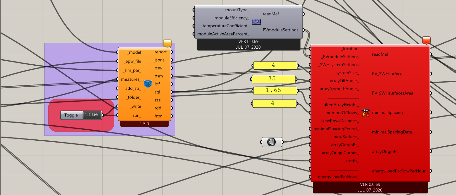

PV modules compability with LBT 1.5.0
I would like to use the existing components to calculate PV and PVT potential on my energy model. However I use LBT 1.5.0 and it seems that the components are only compatible with VER 0.0.69.
Is there a workaround to not downgrade my LBT version for only this exercise?
Thank you
You can have Legacy and LBT versions installed alongside each other. You can use this approach until we have more robust methods for modeling PV in the LBT plugin.
