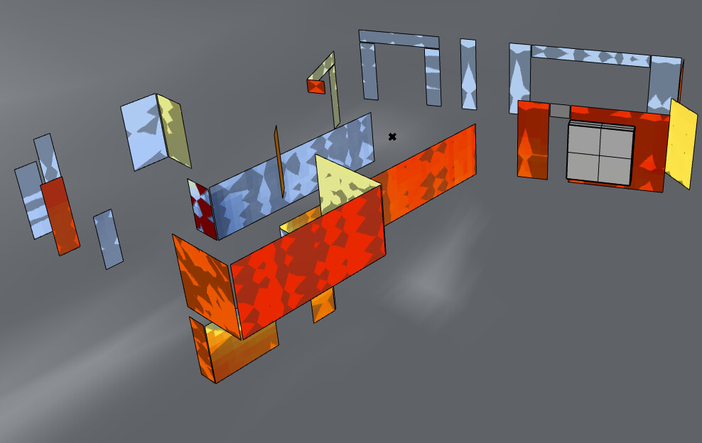

Radiation analysis in Ladybug, uneven colors
Can anybody help me understand why is my analysis showing up like this?
@Gul Try hiding the preview of your geometry!
The glazing is already hidden. It’s a single surface geometry.
This is what they look like .
@Gul , try to turn the preview off the referenced brep inside your Grasshopper script AND also hide your rhino geometry.
Internalize the data and upload the.gh if you are not able to solve it
thank you!! it worked.
