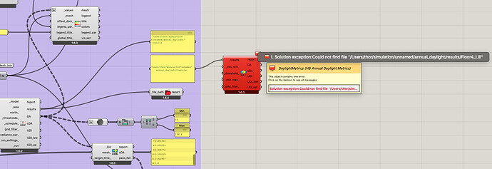

Results (Daylight Metrics) not finding file path
Hi there,
I’m relatively new to this, but when I instruct HB Annual Daylight Metrics to find results within a folder I’d just sent results of an annual daylight study to, it says there is an error in finding the results. (Image below).
I have multiple rooms on a building floor, but I can’t yet see any reason why it shouldn’t work anyway? Any help would be much appreciated! Thank you!
Hi @thorwinkler,
Did you create a model with just aperture groups? I.e., no regular apertures.
If not then I suggest updating your core libraries with LB Versioner. If that does not solve the issue please share your file.
Hi @mikkel - that was the exact issue! thanks very much
