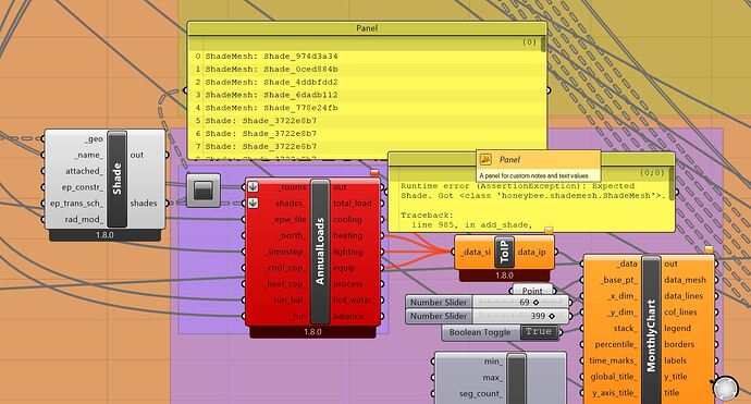

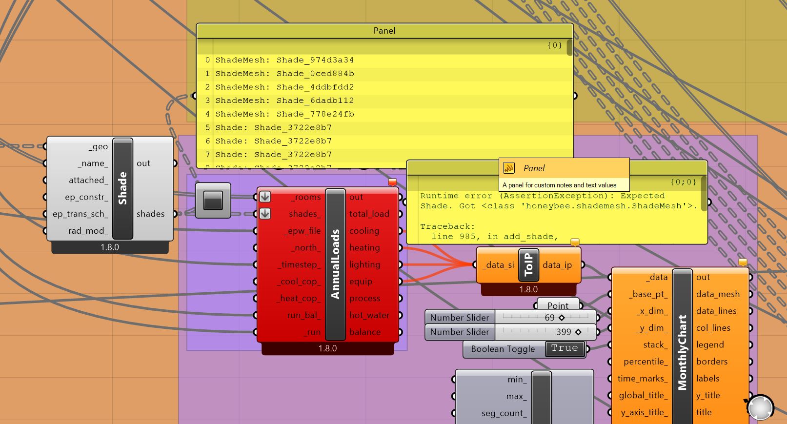

As you can see in that process, the existence of Shademesh conflicts with the usual workflow.
Any reason why this class exists instead of having all Shade objects.
If it’s a logical problem, maybe it would be wise to mention what kind of inputs are accepted, specifically.
