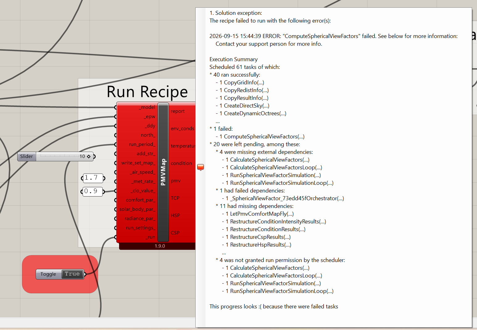

Hello friends. Right now, I’m doing a simulation for operative temperature mapping. Previously (yesterday), the simulation can finish perfectly and showed the OT mapping results. However, just today, without changing anything from the grasshopper file, the simulation cannot finish with the error “1 failed: 1 ComputeSphericalViewFactors(…)”

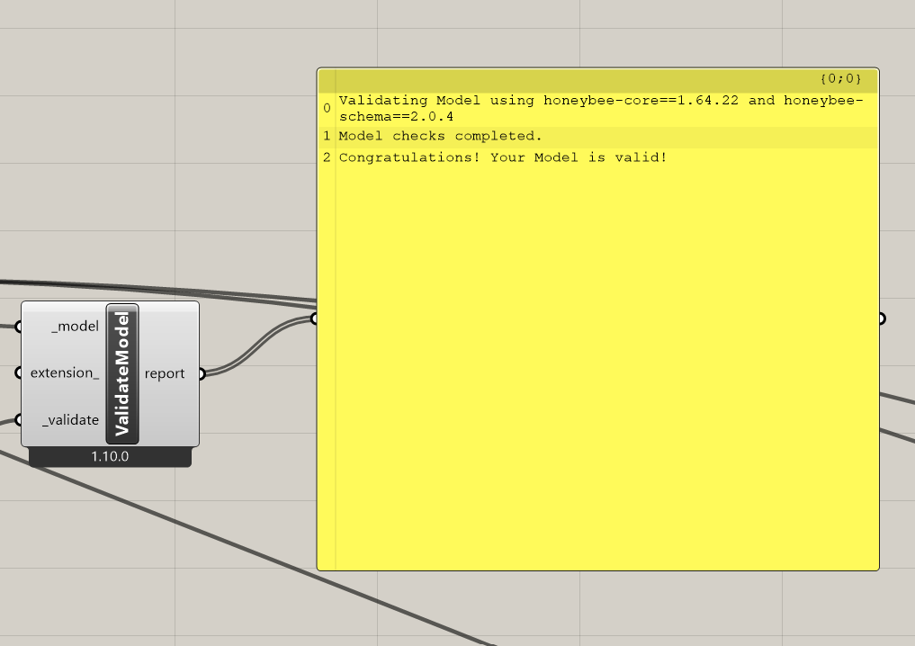

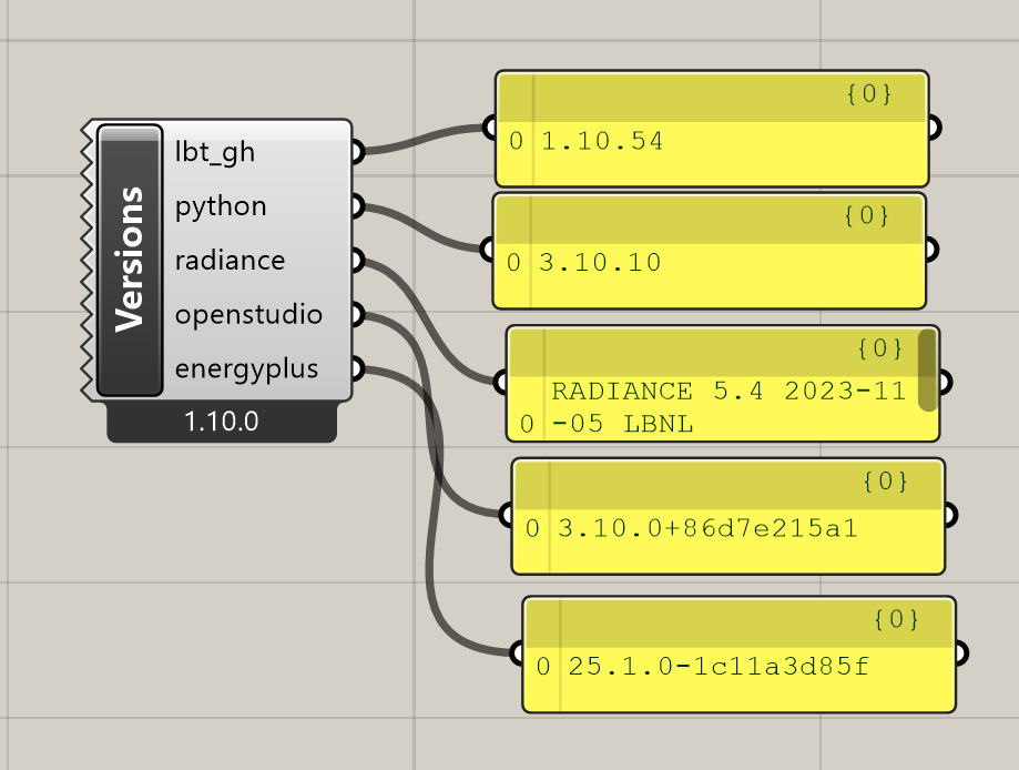

Based on what I found on discourse, the problem could be solved by checking the HB validate model, updating the radiance version. The HB validate model and radiance version shows that the model is valid and the radiance version is the latest. Does anyone know why this happens? thank you very much.
Hi all, it turns out the problem is caused by a space of the grasshopper file name.
