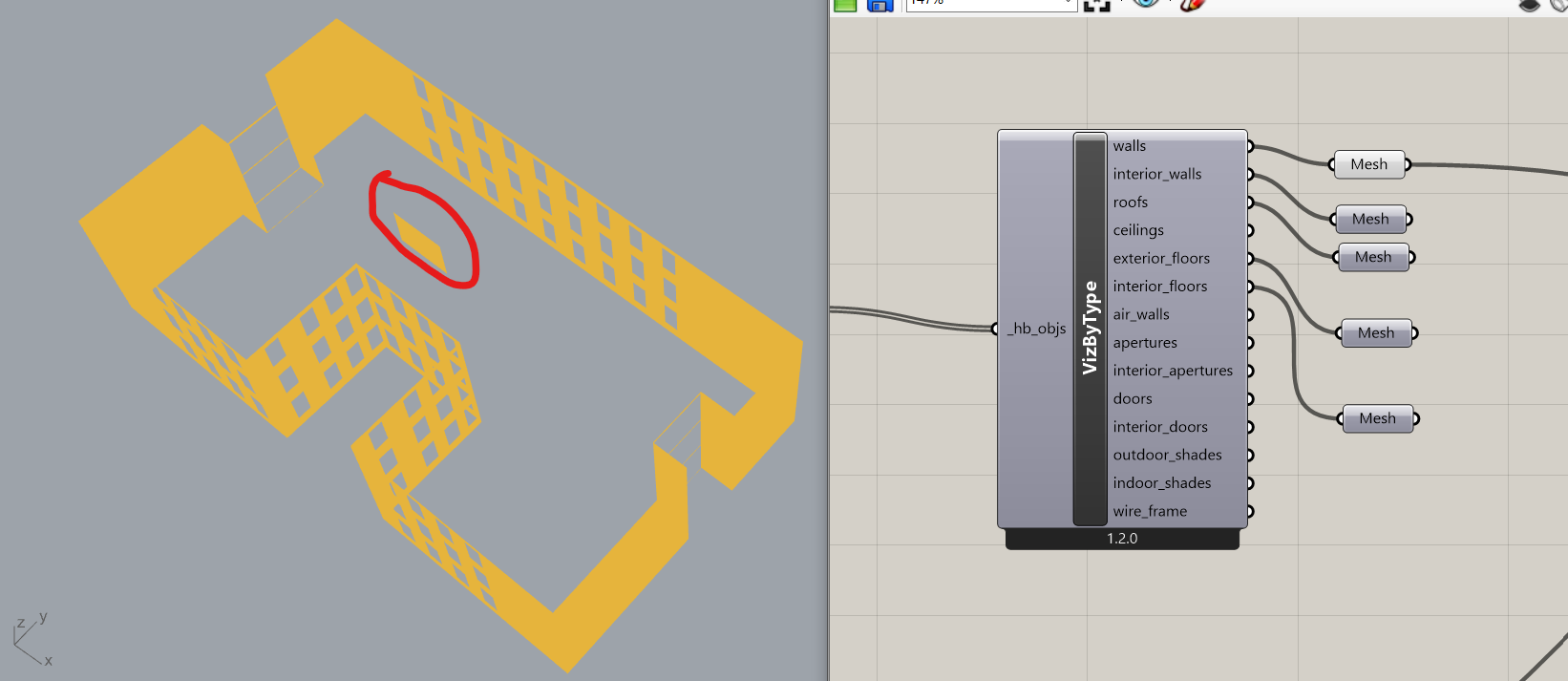

Solve adjacencies and creating rooms is taking one internal wall as external
When I am solving adjacencies and creating the the geometry for my energy model, visualize by type is showing one internal wall (Marked in red in screenshot) as external wall. I am a beginner with ladybug tools.

In that case, your geometry isn’t perfectly matching an adjacent Face. Zoom into that part of your model and see if there are any gaps that make the 2 Faces non-adjacent.
