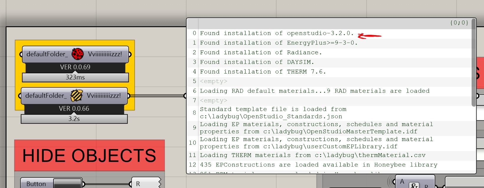

I have Open studio 3.0.1 installed to work with Legacy and Open studio 3.2 to work with Honeybee1.3.
However, I can’t seem to run any energy script for the Honeybee Legacy and I get an error because the Legacy only reads the Open studio 3.2 installation on my PC.
How can I make the legacy work with the 3.01 without uninstalling the 3.2 version?
