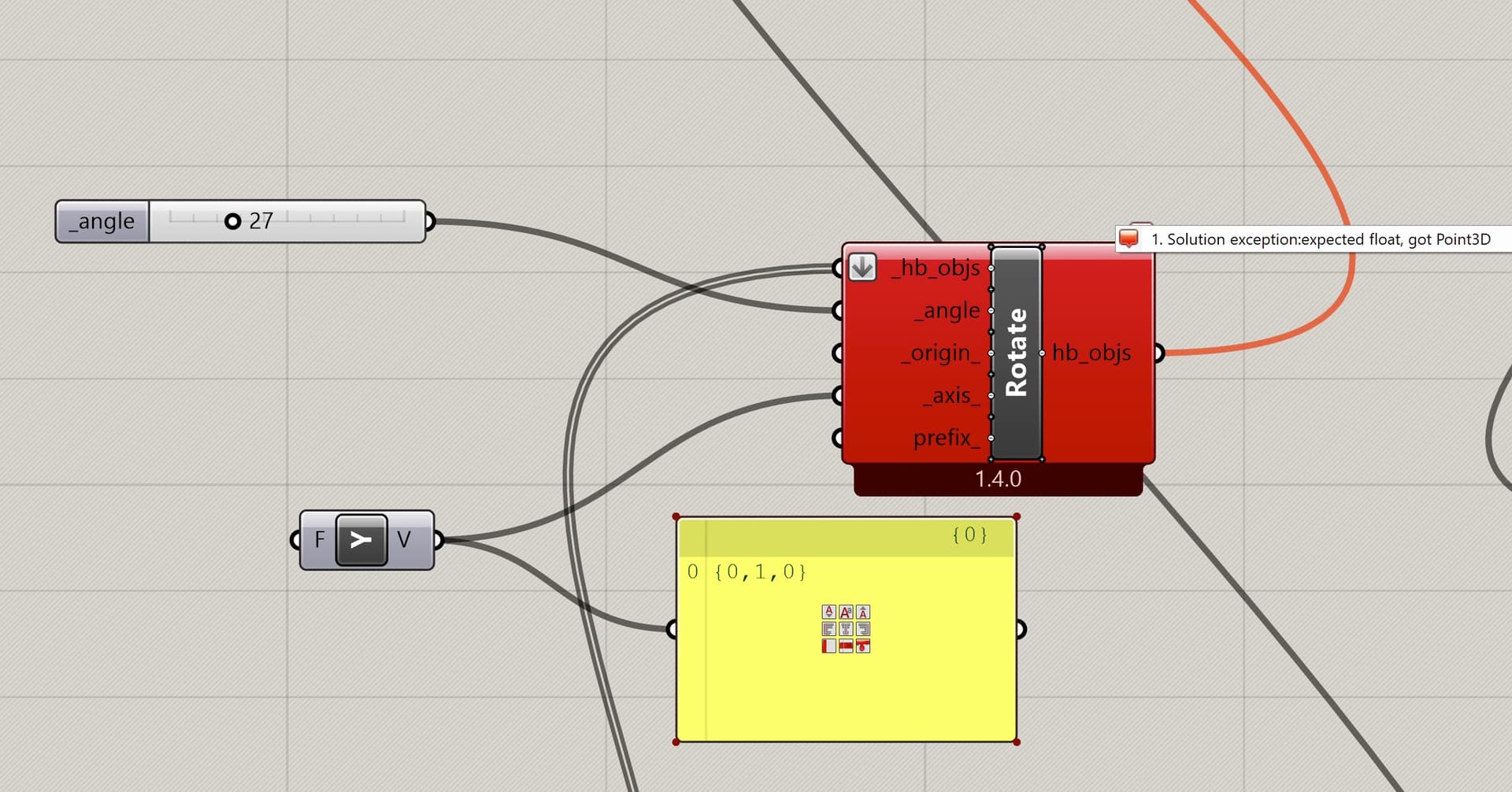

Thanks for your help. Without a vector plugged into the axis, the rotation works fine. I tried plugging in the X-axis and Y-axis unit vectors as well as many other grasshopper vector components and I always the get the same error: “Solution exception: expected float, got point 3D”. Attached is a screenshot of the error and setup.
Hi @julian108 ,
Ah, that’s a bug. This has been fixed in the development version of the LBT plugin for some time now:
You can get the fix on your end if you run the LB Versioner component and it will also be in the upcoming LBT 1.5 release.
