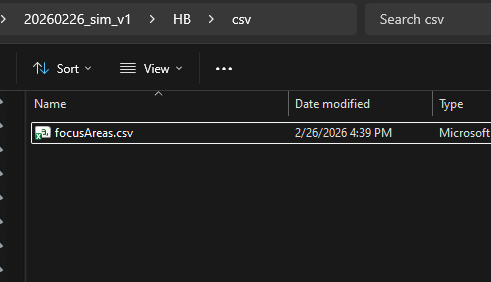

I am attempting to use CFD wind speed results as inputs to the wind_speed input of the UTCI Comfort. I fed the folder path to the input, but upon running the simulation this error shows up. The csv file has also disappeared from the original folder containing the csv file. Note that the simulation runs without problems if I don’t feed custom wind speeds.

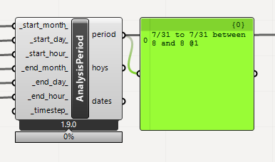

Would be grateful if someone could have a look! I have attached the csv file. I am simulating for one hour only.

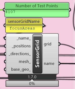

I’ve put together a sample gh file and wind speed (in the zip file). The rhino file is in this google drive link: https://drive.google.com/file/d/1gnv_sBPa_dISPWEIoWxtKKIQ9_CnUOda/view?usp=sharing
focusAreas.zip (314 Bytes)
20260304_UTCI_test.gh (77.1 KB)
