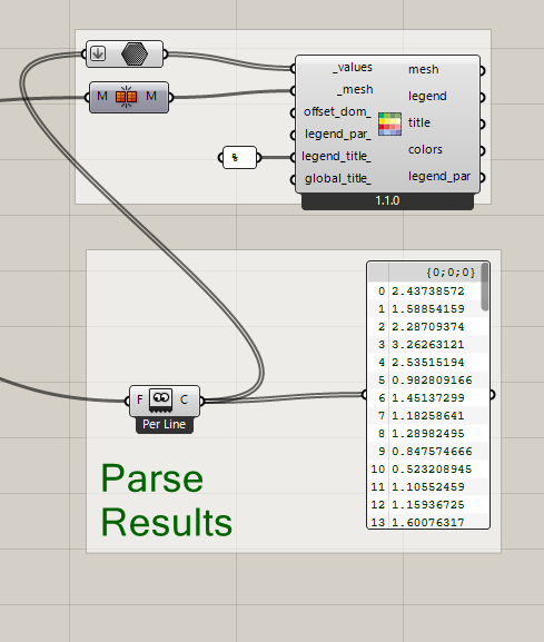

I am able to view results for annual day lighting as well as illuminance. However i cant seem to figure out how to visualize daylight factor as a grid. The tutorials i found are not updaed to version 1.1 and seem to work a bit differently.

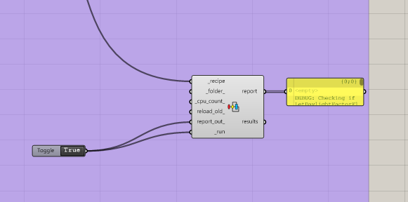

You can update the RunRecipe component with the Versioner. AFter restarting Rhino, and updating the canvas, you can connect the results output with the Heatmap component, as you are probably doing with the AnnualDaylighting analysis.

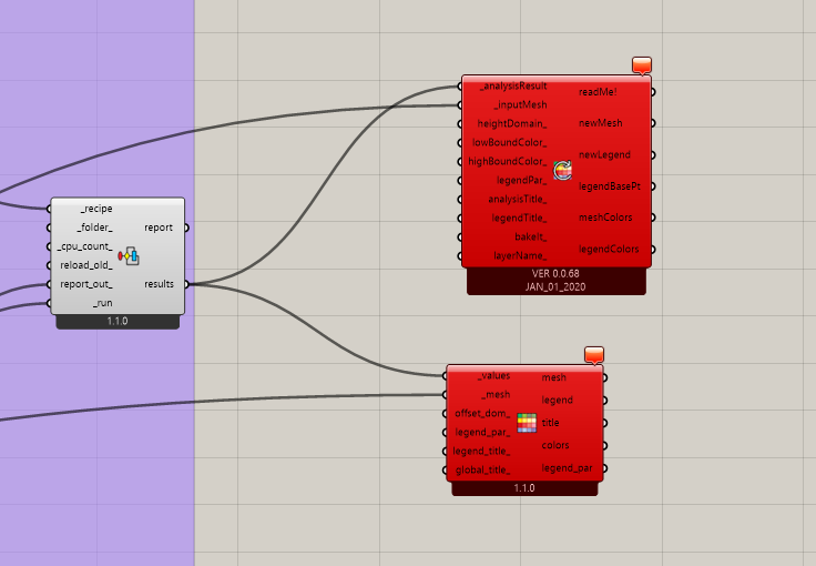

The runrecipe is the latest version. The analysis result is from version 0.0.68 but worked fine analyzing lux levels. I tried both visualization methods and they dont seem to work. For annual daylight you can choose the values to plug into the values component to visualize. I think i might be missing a step.
You are not supposed to mix legacy and LBT.
Check the DF sample that comes with the installer you download from food4rhino. The workflow will be much clearer after that.
