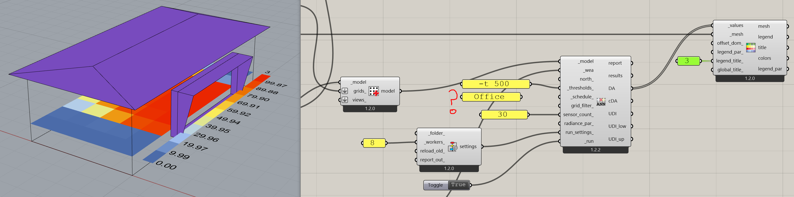

I am a beginner with Rhino 6 and Grasshopper and need it for my bachelor thesis. It is quite an interesting topic: a daylight simulation in a 2 person office. A self-made facade is attached to the window from below.
Anyway, I need to simulate my model for this work.
First I drew the room with a large window and a transition. (At the transition my facade element is hung in the nachgang).
Second step:
The sensors should be placed 80cm above the floor. I managed to do this, but unfortunately it does not work. I have no idea what I can change and need your help.

The evaluation. I think there are some things not working correctly.
I would be very grateful if someone could look at my problem and maybe give some info/tips.

It works for me after i unplugged the panel of the schedule. The “office” schedule is not defined.

I delete the name of the schedule, but even if i switch over true there is an error message.
“No radiance installation was found…”
I installed HB and LB and don’t quite understand why it doesn’t work. I was also looking for a solution on the Internet, but the pages are not accessible.
You should install Radiance for daylight simulation.
