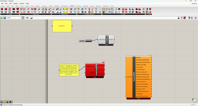

Hello, could somebody help me, i am trying to connect the DownloadEPW weather Url and it says 1. Solution exception: Download failed with the error:
Unable to connect to the remote server. I have downloaded the Ladybug tool from Pollination. I was trying to copy url from here : https://energyplus-weather.s3.amazonaws.com/europe_wmo_region_6/GRC/GRC_Athens.167160_IWEC/GRC_Athens.167160_IWEC.zip
and downloaded the EPW file from here : https://energyplus.net/weather-location/europe_wmo_region_6/GRC/GRC_Athens.167160_IWEC
But i am not sure how could i use it farther and how to find a solution. Could anybody help me ?

Check what is the error in the first image [red component].
In the second one [orange] pay attention you need to connect the URL also.
If the EPW is already downloaded you can connect it directly using the native GH file component.
