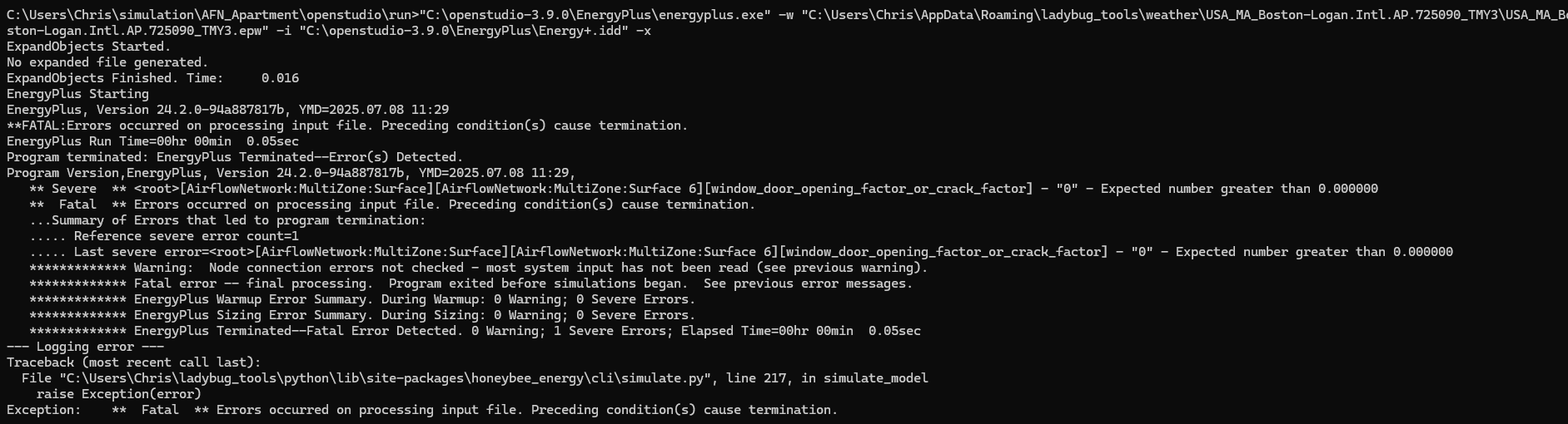

The line of code that I added was correct and it was helping work around this fatal error that EnergyPlus throws if you set the SimpleOpening object up to have a zero openable area:

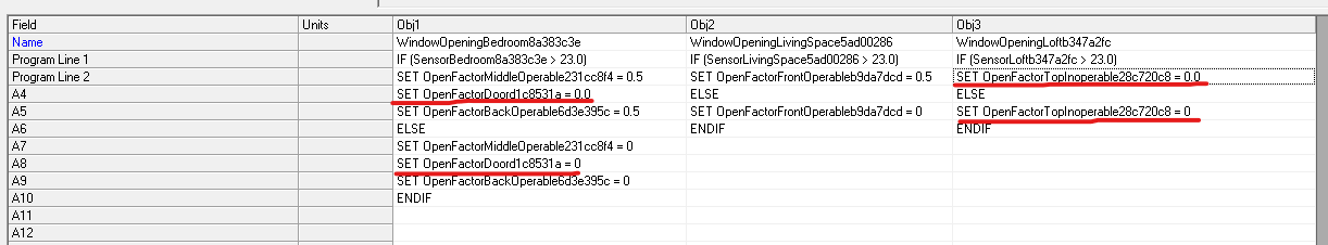

However, I put the line of code in the wrong place such that it was also causing the EMS program to set the window opening to 1 instead of zero (and the EMS program always overwrites whatever is specified on the SimpleOpening object).
I just pushed a change here to put the line of code in the right place:
… and I verified that it writes the correct EMS program for inoperable windows and doors:
