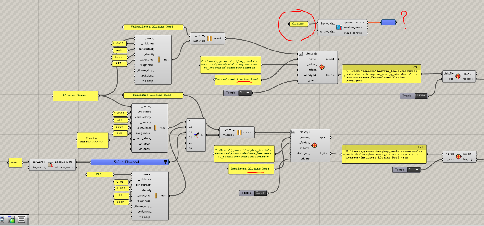

Hey @chris ! and everyone in this forum! I know it’s been long since someone post anything, but I’d like to ask for some help. I’ve followed all suggestions given in this forum but still can’t solve my issue, which is similar to that of @Romain .
I made some new Opaque constructions and used the HB Dump Objects to save them as a JSON file. However, when I search in the HB Search Constructions component for the newly created constructions that I have dumped in C:\Users\[USERNAME]\ladybug_tools\resources\standards\honeybee_standards\constructions folder and C:\Users\[USERNAME]\ladybug_tools\resources\standards\honeybee_standards\constructionsets folder, they don’t appear as part of my standards library. I have also followed the suggestion of restarting Rhino/Grasshopper but doesn’t work either. Can you give me a hand on indentifying the issue?
I am running Grasshopper 1.5 version. Grasshopper file is attached. Thank you in advance.

Hey @jgamero ,
Sorry for the confusion. The location of the user standards folder has changed between LBT 1.4 and 1.5. The user standards now live in:
C:\Users\[USERNAME]\AppData\Roaming\ladybug_tools\standards
So just dump your construction JSONs in there and they should be loaded when you start Rhino/Grasshopper.
FYI, we moved the user resources here so that your custom schedules and constructions are not uninstalled whenever you uninstall or update Ladybug Tools. So you can just put them there once and not have to worry about them going missing if you uninstall ad reinstall.

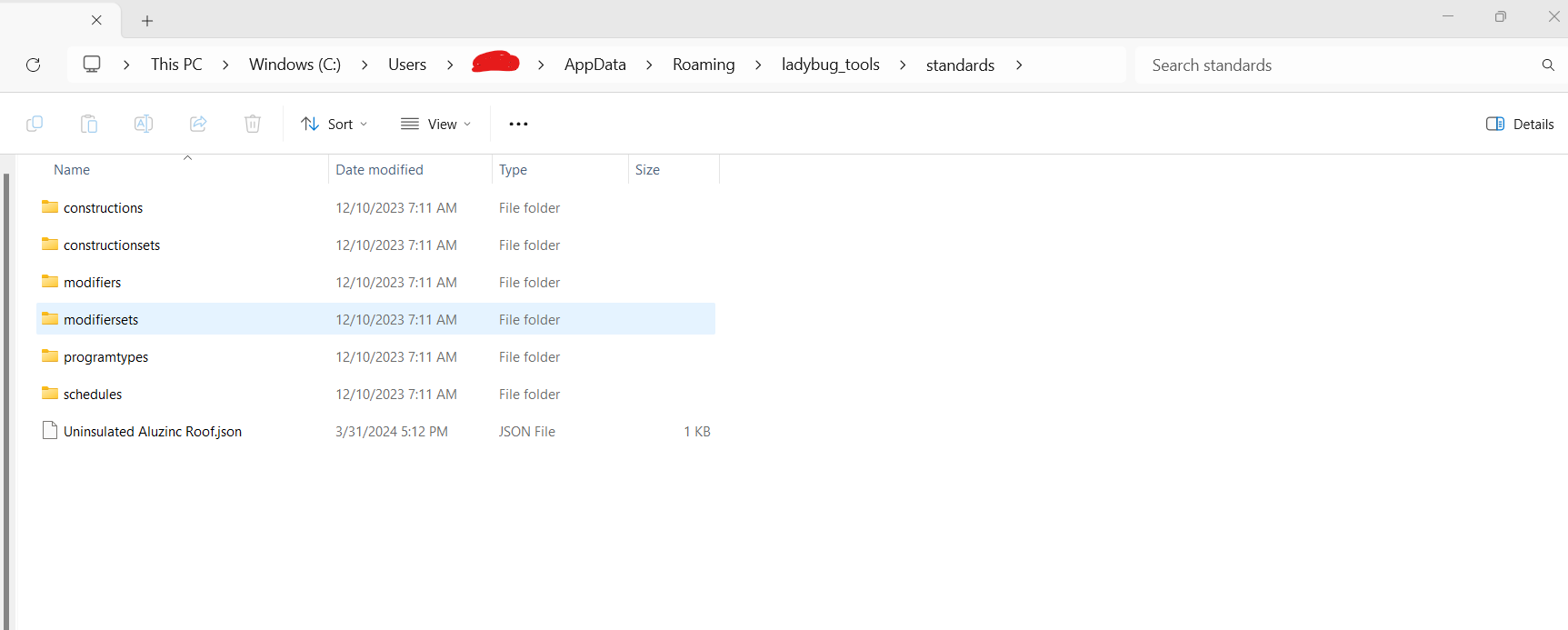

Sory crish, Sorry Crish, I’ve been practicing it but it doesn’t have any effect on my components. i use LBT 1.8
Hi @adenurmap ,
You’re almost there. You just need to write materials like that into the constructions sub-folder of your standards folder. Once you do that and restart Rhino/Grasshopper, you should see them show up with the “HB Search Constructions” component.
