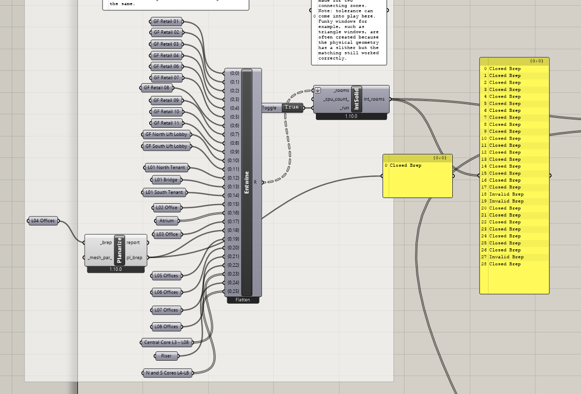

Hi all,
I am having issues with this in v1.10.0
As you can see in the screen shot below i am getting invalid breps out of intersect solids even though the brep being fed in is a closed brep. This is giving me geo is not a closed volume error at the room solid component. additionally these are unaltered geomtries that have run without this error just a few weeks ago (no change to tolerances or LB verisons).
mostly this is caused by inaccurate modelling. Everything you draw by hand can have small inaccuracies. Sometimes really small.
