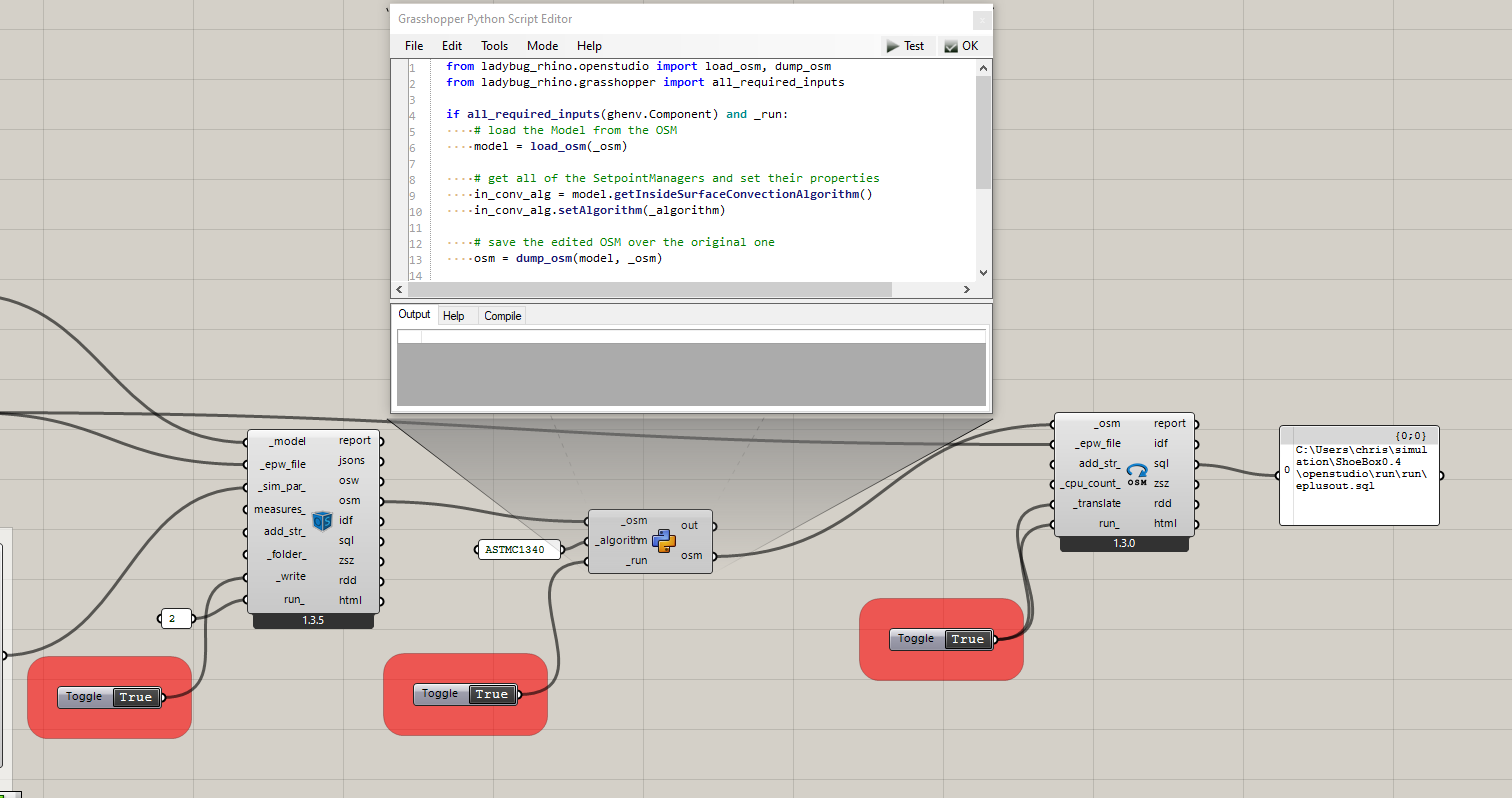

Hi @Sobrado ,
This is easy to do if you are on Windows with the latest development version of the plugin where you can import the OpenStudio SDK to Python like so:
sample_editing_osm_conv_alg.gh (58.8 KB)
