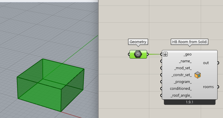

hello, i can not found the HB masses2zone in the last version dose it changed?
@Cav does this component accomplish your goals?
