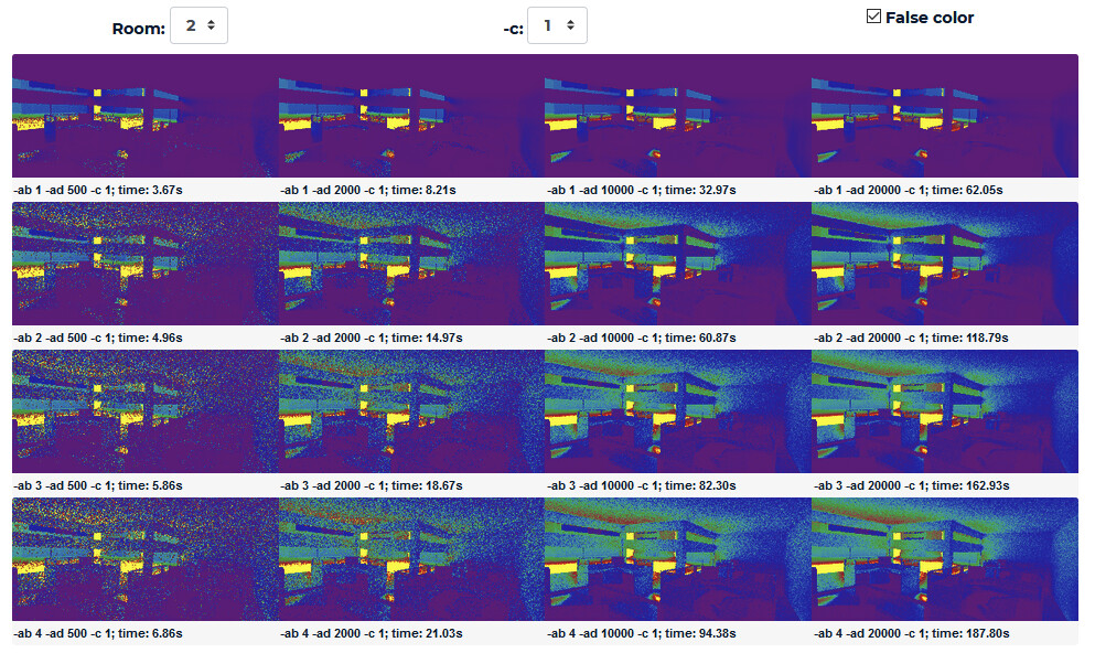

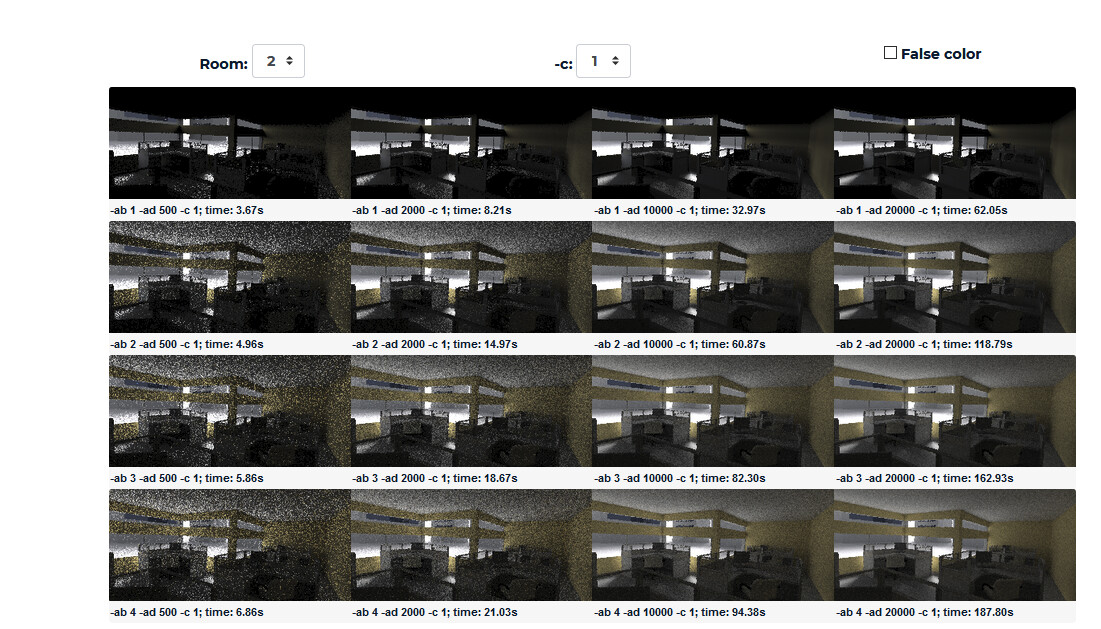

PS: Here is a little basis for comparison:
The difference between the results with -ab 3 -ad 100000 (82.30s) and -ab 4 -ad 20000 (187s) isn’t much. So if the user had the ability to see this in real time probably they will stop the simulation at some point…
