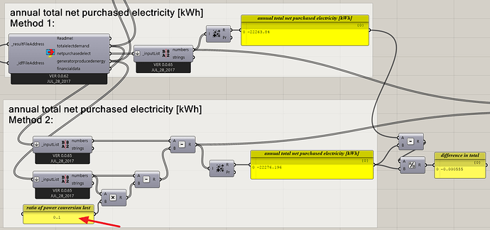

I checked the EnergyPlus HTML output file, and it seems there is a Power Conversion in the calculation of net purchased electricity:
So, the correct workflow for method 2 should be the following:
now the hourly difference between the two methods is quite small:
I assume the Power Conversion is related to the inverter efficiency which is specified as 90% here, i.e. only 90% of the electricity generated from PV will be converted to AC electricity going to utility or the grid, and 10% will be lost in the process.
Is this interpretation correct?
