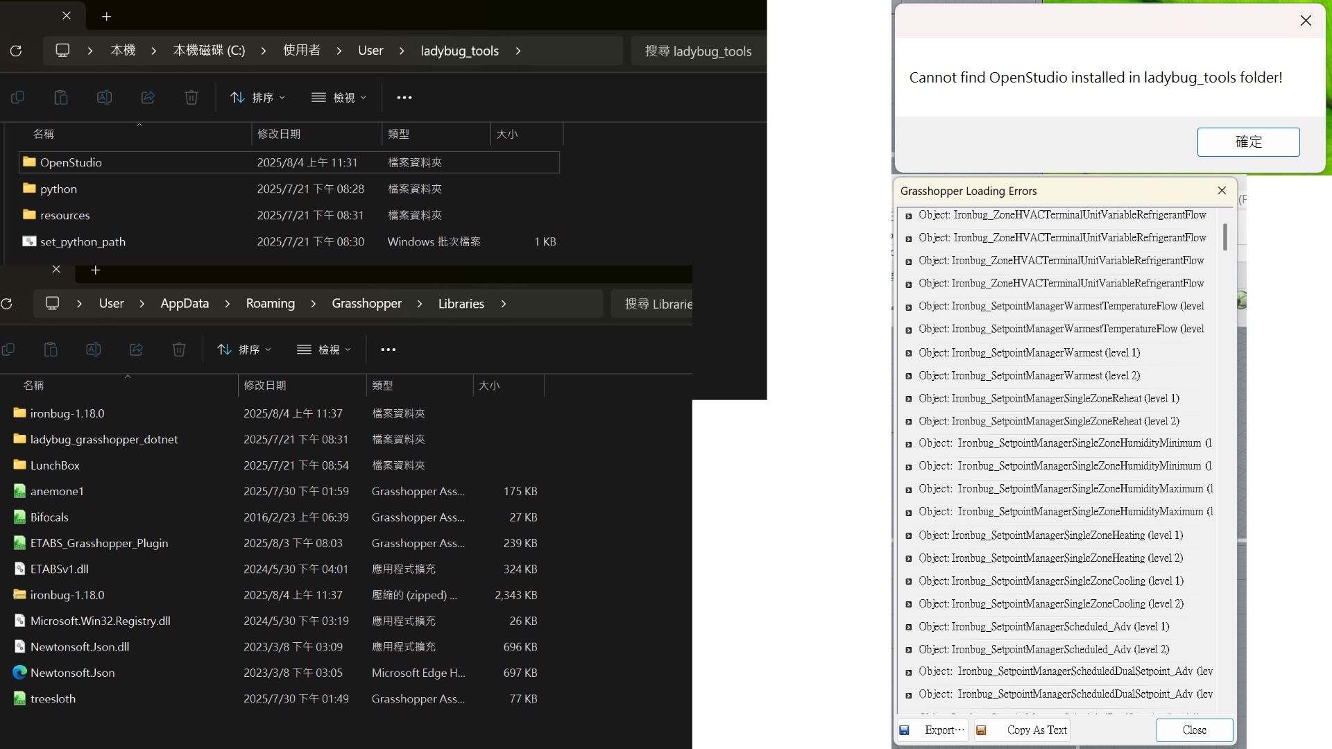

I got the same issue about installing the Ironbug plug in.
My tool version are openstudio-3.7.0,LBT 1.8.
And I manually copy the openstudio-3.7.0 from C:\ to C:\Users\User\ladybug_tools folder
What mistake did i make or any step didn’t taken?
Thanks,
Lynn

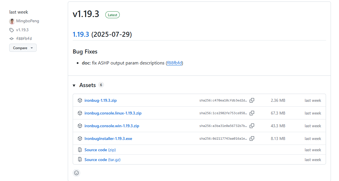

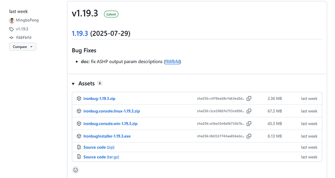

You can user Pollination one-click install for ladybug and ironbug.
If you want to upgrade newer ironbug, you can install it using the exe file from github release.
OK,it works. Thank you!
