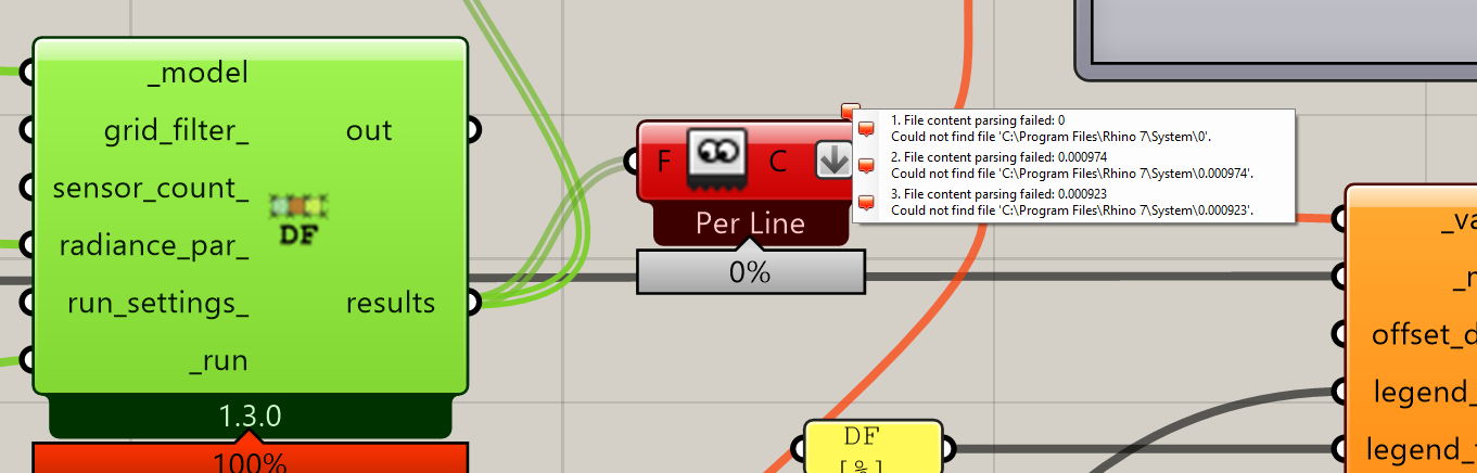

I am working on a HB file to calculate DF and I get the following errors when starting to visualize the results:
  1. File content parsing failed: 0
    Could not find file ‘C:\Program Files\Rhino 7\System\0’.
  2. File content parsing failed: 0.000974
    Could not find file ‘C:\Program Files\Rhino 7\System\0.000974’.
  3. File content parsing failed: 0.000923
    Could not find file ‘C:\Program Files\Rhino 7\System\0.000923’.
Does anyone know where this error comes from?
Best,
Nima

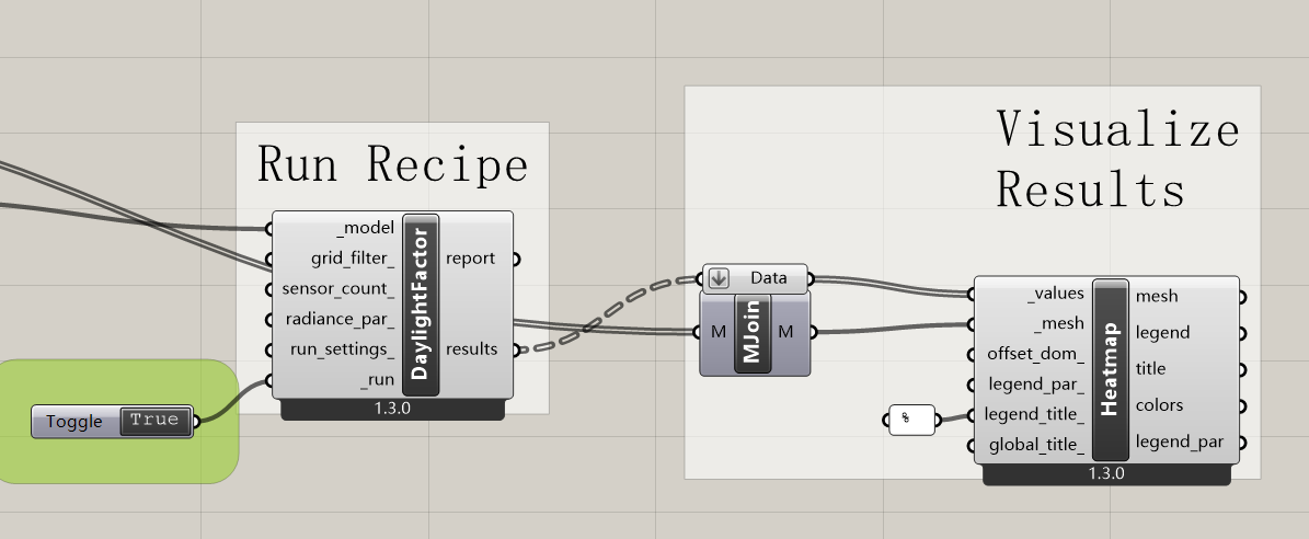

Hi @Nimafo It is a miscake for Grasshopper. The results of daylight factor is data, not a file in your drive. You can connect results to Data compotent for HeatMap.
Great, thanks @minggangyin .
